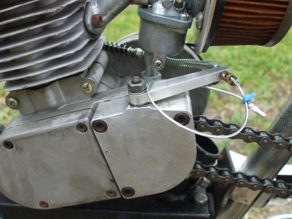

Great detail shot. So what is the deal with this clutch arm?
Is it longer? Better angle to the cable stop?
What makes it an improvement over stock?
It is a redesigned milled cover with a different angle on the shaft that pushes pin in that operates the clutch. It makes everything smoother and easier to operate. He only made these a short time and stopped them due to they did not fit all engines and some people had trouble adjusting them. You have to custom fit the pin that operates the clutch by grinding it fit right.
