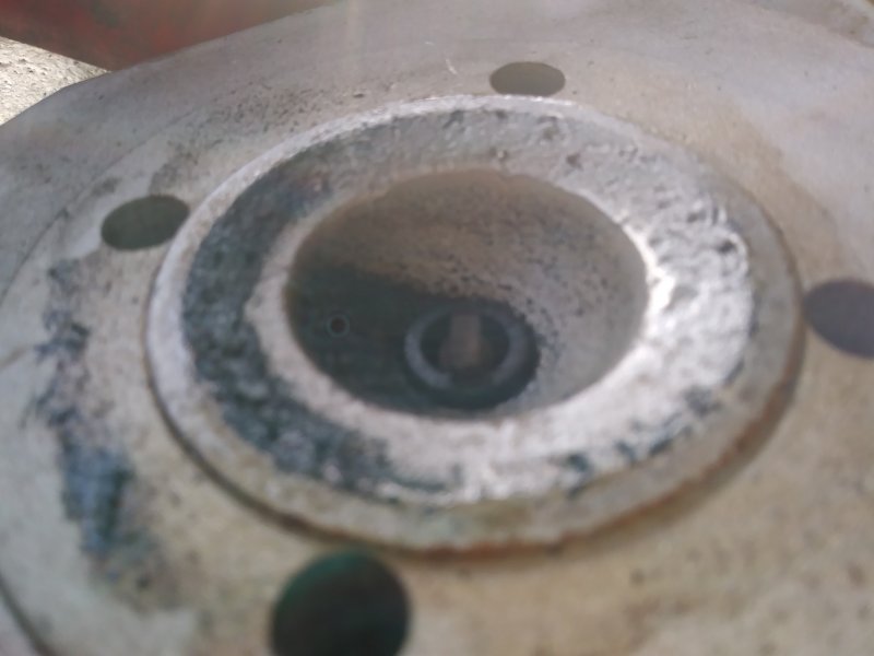

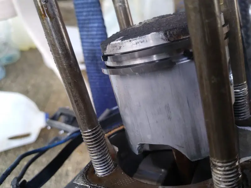

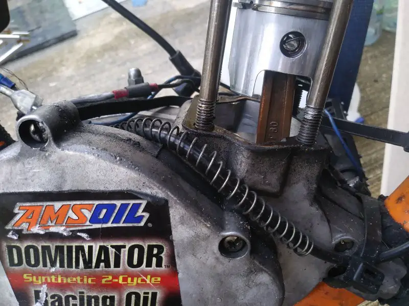

did a check up on my engine I built just to make sure all is good. looks like I did a good job, I ride 80 mile commutes 3x a week and ride a minimum of 10 miles a day.
Most miles are using 50:1 AMSOIL Dominator, just started using AMSOIL Saber mixed at 100:1 for the last 300 miles. gues there is no need to change anything.

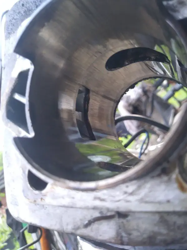

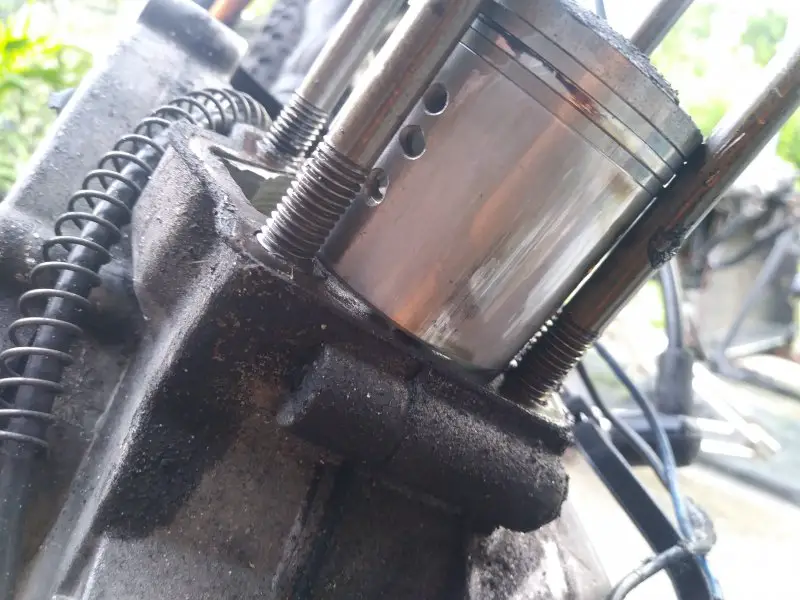

no pics yet, too lazy but I spent the day porting a new steel liner that I had honed to fit the piston and installed on my bike a few hours ago and went out to celebrate my b-day and the liner slid down the hole and made me pedal back home about 5 miles. already put the pictured above cylinder back on with the new rings I just should of done in the first place but of well! the whole time pedaling back I thought the piston was starting to sieze up but nope some 4 year old in china was on his first day on the job trianing and sent me a DUD. pics later.

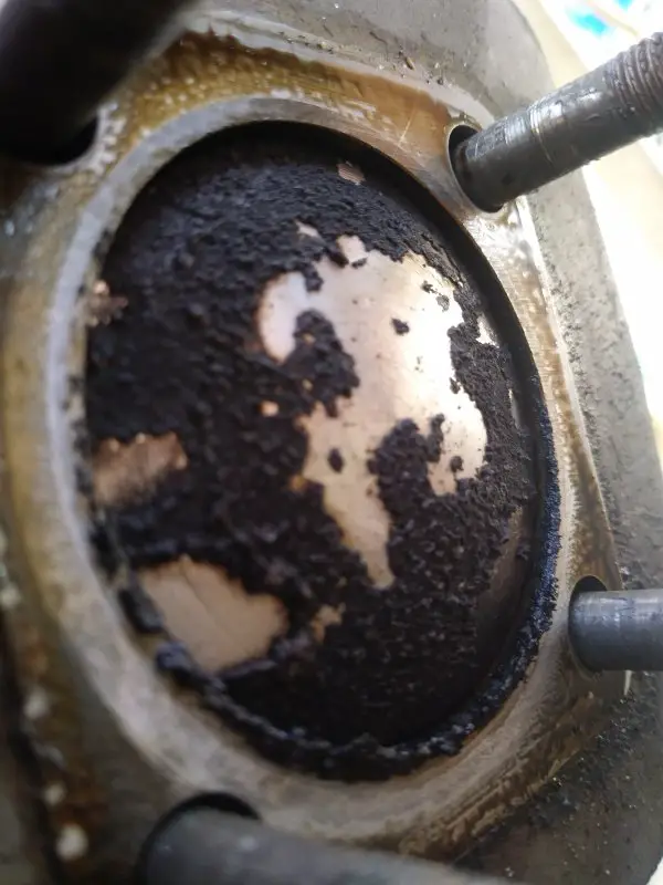

Took it out last night it would not start till I checked for spark as I was trying to start it yep it had spark then it started to fire and it finally lit off, the choke is so annoying on my carb I have to get off bike fumble around to pull it up and most of the time I do not need it. Strange, when I first bought carb with larger jetting the choke would work like normal then after time the engine would lite off without choke, then I leaned out the pilot and main and normally starts without choke. From what I read if a Dellorto starts fine no choke you can go leaner on pilot jetting. anyway got the bike running and it sputtered coughed backfired most of the ride about 15 miles round trip, had to slip clutch to keep it going must of got water in the gas tank or pilot jet got trash in it. Everyday something new with motorized bicycle. been a real bad 3 weeks for me. Least I have plants growing food at home I scavange. picture shows root cause of loss of power after about 2500 miles worth.
