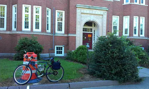

I got up early to go for a ride. The sun is shining and a nice breeze is blowing. This marks my last free day as my graduate classes start tomorrow. As I've lost my SIGMA 1200 I used my SIGMA 800. After 1 mile in I notice it's only reading 13mph. I pull over, reset it, and go on my way again. After another mile I notice it's reading 44 and nothing else. I pull over at the old Winslow School and pull it off again. I've never had any issues with the Sigma computers and the only change that I made was to move the mount to the bare aluminum stem. So I move it back. It worked flawlessly the rest of the 14 mile scenic trip.
Eagle Arse at the Oak School by lessherger, on Flickr
In my pocket I had my phone with the MapMyRide app. I use the app to map out my rides and figure out what route I want. The stupid thing doesn't give directions. No, it only announces my "splits" on the mile and how many miles I've ridden. What kind of stupid map app doesn't give directions? stupid. I want an app where I can plug in a route and the app gives it to me via the ear buds. (or one ear bud.)

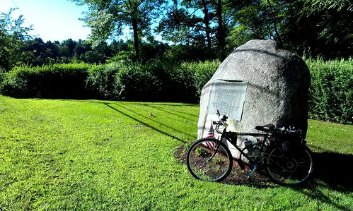

Anyway, the ride was mostly uneventful. I rode up to Wenham, where I'm not very familiar with the roads and at one point I pulled over to check the app for directions. I don't have a kickstand on the bike and I laid it down on the grass. This was a bad idea. The gas flooded the carb and upon starting up cause the happy time engine to sputter and spurt and cough a bit. After a few terrifying seconds the engine smoothed out and went with no further problems. Note to self: get a kickstand ASAP.
Eagle Arse at the Wenham Monument to Some Pastor by lessherger, on Flickr

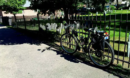

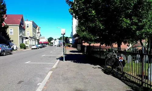

When I got back to town I swung past the firehouse and took a stop at the Old Cemetery and took a pic of the bike under a tree.
Eagle Arse at the Old Cemetary by lessherger, on Flickr
We are just a few weeks away from all the college students return from summer break. We've got 3 colleges in this city and I never look forward to their return. They bring a lot of revenue in but they also bring a lot of parties and in general loudness and bad driving.
The heavy rubber eagle arse grips are pretty comfortable and the eagle makes them more oval shaped than round. Which is surprisingly comfortable and allows me to rest my hands more often. My gloves have been shredded by the grips. The faux leather palm had a small tear before the ride then tore out during the ride and left me with a giant hole. I'll have to replace them with a better gel palmed glove. I had attached a nice reflective strip to these gloves so I'm sad to see them go.
