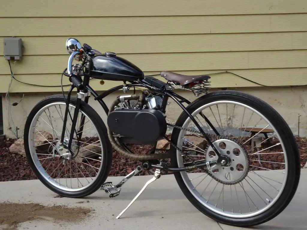

Thanks for the recent compliments guys. I think it's feedback that fuels us all to keep going. I'd like to get the thing powder coated a different color, but I have no idea what color??? Probably a prewar look, something with white or grey rubbers.
There's a top view in post #37 where you can read the Gyes stamp. Nice looking bike!

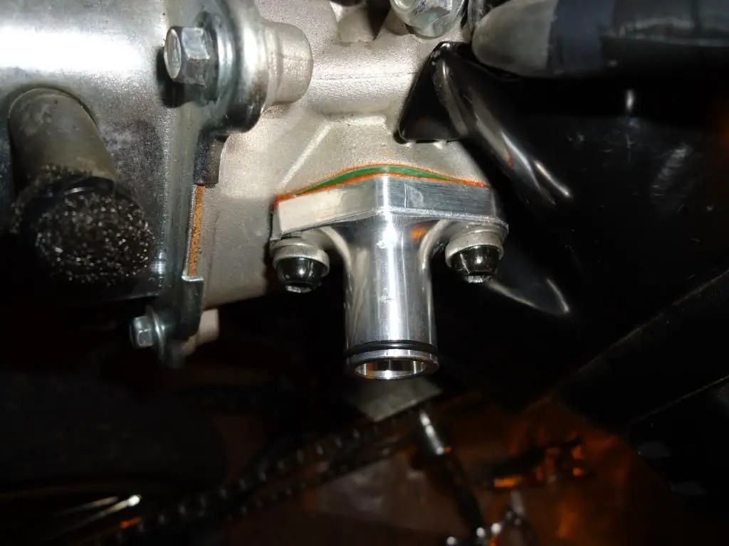

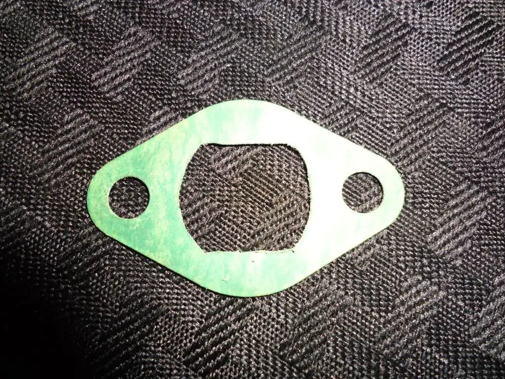

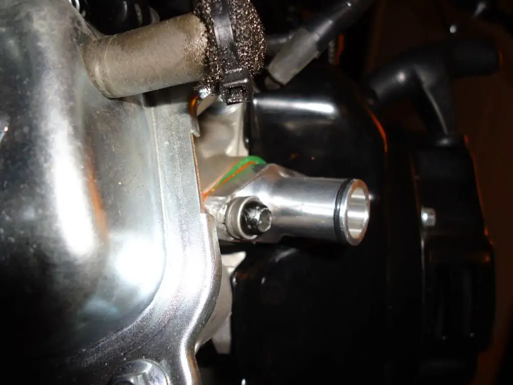

So the time has come for a better carburetor. The 99cc is okay in close to stock form. However when you start to modify the engine the stock carb just isn't enough. I didn’t like the selection out there for aftermarket carbs. The stock carb on the 79/99cc predator has a bore of .428” or roughly 10.8mm. AGK offers a claimed big bore carb that has a bore of .487” or roughly 12.4mm. That to me is not much of an improvement for the money. The 12.4mm throat on the BB carb is smaller than the stock NT carb which is around 13.3mm. So last Saturday I experimented with some parts lying around and have produced some amazing results…
I opened up the stock gasket from the 99cc. I have an old 40MM billet intake that I want to use. One speed bump with it though... the manifold bolt spacing is 40mm center to center and the bolt spacing on the engine is 38mm center to center. Now that that is taken care of I can mount it up>>>
I think I skipped a picture or two, sorry!
Fits great!!!I'll post the rest as soon as I have time...

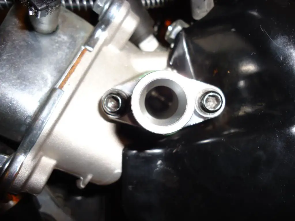

continued...

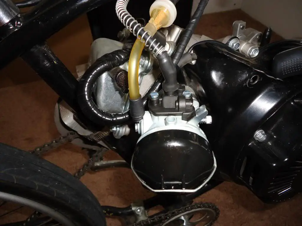

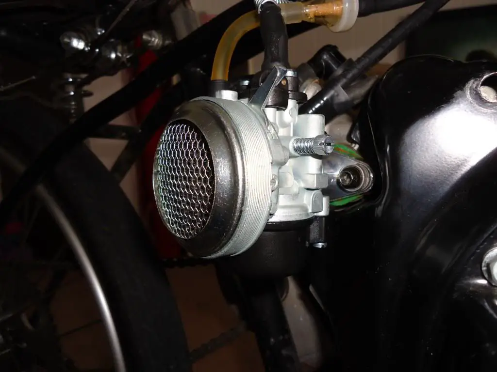

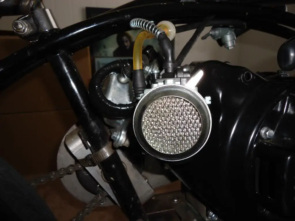

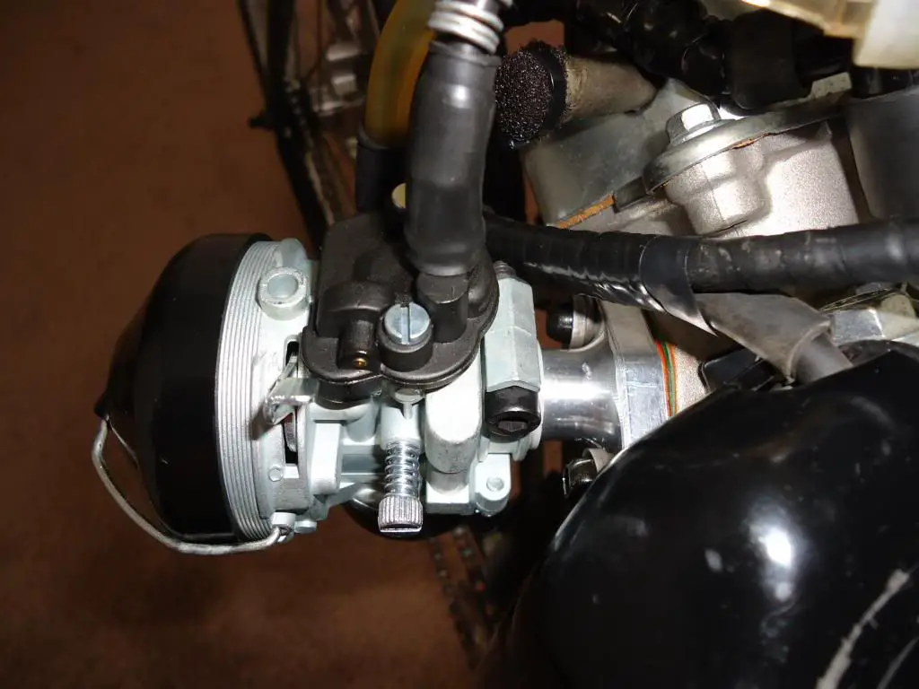

Perfect fit and a nice tight seal. My carburetor of choice is the Dellorto SHA; it has a flat slide and a 14.1mm throat; plus it was just sitting on my tool bench waiting for another 2 stroke build. I use these carbs on all my 2 strokes and they have never disappointed me. No more stock POS>>>
I do not like the plastic cover, so I'll leave it off. It looks more vintage. I just need to drill some small holes and screw it in place to keep the filter from falling off.
I haven't had a chance to take it out for a 50+mi ride yet, but... I can tell just from riding it around the neighborhood and to the store that it has a lot more power. Horsepower & torque have increased across the board (especially on the top end), it starts easier, and the idle rpms can be set much lower. I got it down to around 1520rpms without it dying out. I still need to take it out for a long ride so I can play with the jetting and get it dialed in good.
I think the first place will be the hardware store for a new fuel line and filter. Holy Sh*t, I didn't know it was that dirty until I seen what it looks like in the picture.

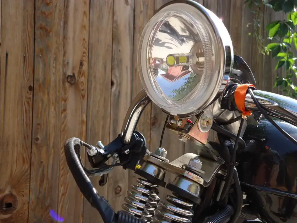

It's an older fog light from my former Jeep. I went to radio shack and got supplies to make a rechargeable 12V battery box. You should be able to see the battery box right in from of my seat.

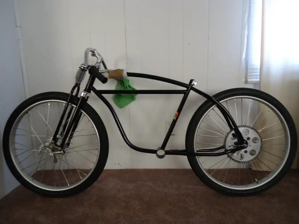

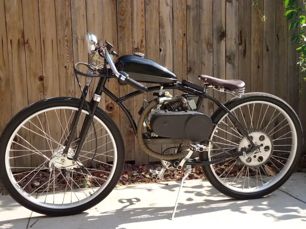

I just picked up a micargi cruiser with 26" wheels that I am currently converting into an electric BTR. I had a few questions I was hoping you could answer for me.
I know you said you were running worksman wheels. Just wondering if they are 26" and also wondering what spec tires you are running. Im trying to hone down my choice of wheels and tires for my bike. I need a strong set of 36 spoke wheels, maybe a tad wider than yours. I like the overall diameter though.
I ordered a set of cruiser bars for my bike, but the center of the bar where it is mounted in the stem is too fat. just wondering where you picked up your bars because they look awesome. I have a straight bart that might work.
The other question I have is whether you modified that seat bracket at all? I like the way the seat is setback. Where did you source the seat?
In no way am I trying to copy your bike. I just like the look and would like to incorporate the board track look into my ebike.
heres a pic of what im working with out of the box
Untitled by danjpendleton, on Flickr
F_Rod81
Dealer
Jan 1, 2011
1,031
2
Denver, CO
The wheelbase looks a tad long because the rear isn't adjusted or tightened. The forks are just there more or less. For some reason the headtube on this frame is for a 1 1/8" headset and not the traditional old fashion 1". Not a big problem, I prefer 1 1/8'', but now I need to buy a headtube reducer so I can use my monark forks. Overall, this is going to be a fun project.
