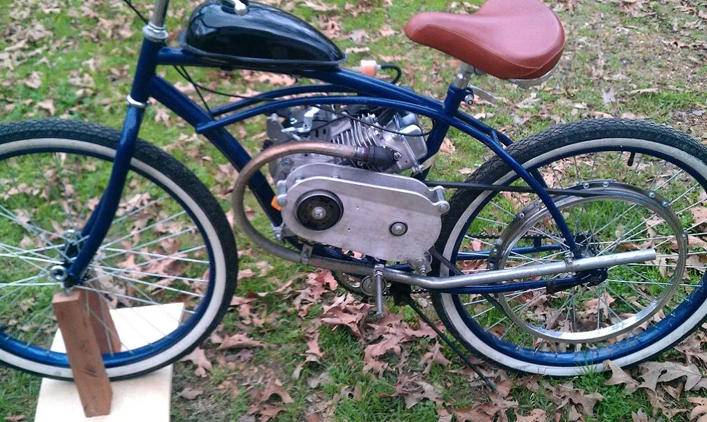

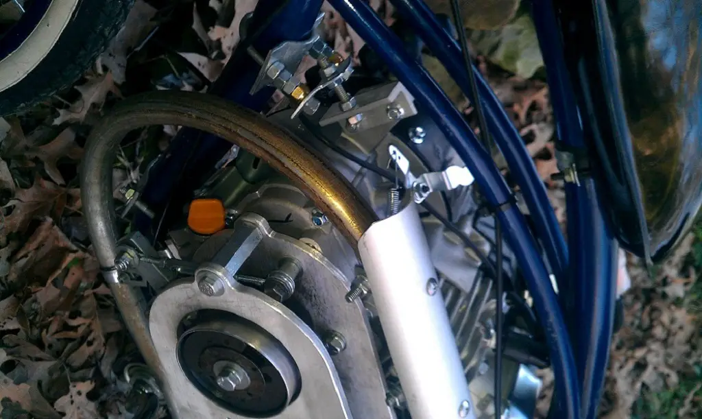

My engine fits kinda tight between the downtube and the seattube. When I first got it installed there was less than 1/4" between the valve cover and the seattube. After about 10 miles use, everything bedded in and the motor moved back until the valve cover stopped it.
I used the BGF clamp on mount, and didn't trust it's rough fit to not let the engine move. I am running a belt drive to the rear wheel, belt has to be kinda tight, so there's already a lot of stress in the clamped engine mount. I added an adjustable front mount that has a short allthread for adjustment built into it.
For the exhaust, I cut the stock flange off the manifold pipe.
I cut the end off a threaded nipple,bored it for tight slip fit for 3/4 EMT.
I then attached the flange and screwed in the modified nipple.
I then bent a piece of EMT to my liking and installed it going foreward with a sweeping 180 below and to the rear.
I then took a piece of 2" aluminum tubing about 10" long and sawed in half lengthwise.
I used 2 EMT bolted clips on the EMT pipe to fasten the split tubing heat shield to.

That's a very clean and good looking exhaust setup. Your pipe nipple arrangement would work perfectly for my purposes because I need to keep the exhaust manifold exit as low as possible since the bike is going to get an in frame gas tank... so every bit of space between the pipe and the gas tank is important. I also like your idea of using the emt clamps to hold the heat shield. Well done, sir!

I forgot to 'splain about the 90 deg fitting.
It is a 3/4 street ell. A regular 90 is too fat to fit 'tween the exhaust studs/nuts.
First I soaked it in muriatic acid/water about 50/50 a few hours to remove the galvenizing, followed by a good water rinse and a little soak in household ammonia to neutralise any residual acid.
I then cut some of the threadded end off to shorten it enough that it still had a little clearence with the end of the exhaust stud. I then bored the inside to match the hole in the flange, then welded them together.
