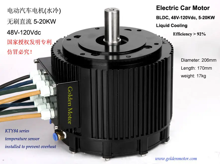

I would go with 5 KW. You will still go fast like the wind. And get the flux vector controller with sine wave output, they are much better than hall device commutation.

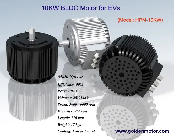

Yep Vector is the way to go for sure.
5kW will go fast but will it go fast quickly? I want to be able to see cars behind me fade fast in my mirror from a stop light. The 10kW will hardly be breaking a sweat. It's rated at 160A continuous.

I would recommend the same. 5 kW is a lot of power, and too much will cause reliability issues for a daily rider especially considering your bikes rigid frame. Even 5 kW seems borderline as it is. Plus your range will be farther.

I guess I'll be gettin this 10kW of illegal magnetic goodness instead of the 5kW!
The problem I see with this motor is that if you want to make the max 20KW power output you need to run it at 120V at 166A, that means you're going to need almost twice as many batteries as you planned for the other one running 72v at 100A, if you have $5k to spend on a bunch of batteries that can go puff if you do anything out of their operating limits, or cells start dying and overloading the other cells and making them fail prematurely, it could be quite an expensive learning experience.
Honestly, if I were you, I'd stick a slightly modded 212cc predator on that bike and enjoy it, you can muffle it to make it quiet and it will be cheap and trouble free for many miles.

Five will be plenty, trust me - :)
Don't forget that full torque is available at zero speed. You will be faster than any car off the line. Not to mention that 5 KW is continuous, you have 15 KW peak.
You better have a stout motorcycle type drive sprocket / wheel or risk ripping the spokes to shreds.
5/15 will be plenty.

You'll need the full 120V to get the max claimed power out of the 20KW motor, that means twice as many batteries run in series to get the voltage required.
At only 60V, it would make 10KW at maximum current flow of 166A for that motor. Again, you should really at least buy a book on electrical circuits or electric drivetrains and read it, and realize that you can't pick and choose your own reality, specifications are what they are, and if you don't follow the guidelines and match your systems specifications throughout it won't perform as planned or at worse it will start killing expensive components. If you blindly go about buying stuff without researching thoroughly how the whole system will work together in harmony, it's gonna be a huge disappointment. Electric bike component vendors must love selling stuff to guys like you, bent on learning things the hard way through puffs of smoke and melted parts.
Facts of life, laws of physics.

220A x 66V = 14,520 Watts. 275A x 66V = 18,150 Watts. That is called 3rd grade math.
Nobody in here, including me, ever stated that 20kW was possible with my 6s33p LiPo battery pack. Now you are just preaching to the choir. laff

The thing you're neglecting to think about is the analog electrical characteristics of the battery-controller-motor circuit. At a lower voltage of 60V you're not going to be drawing a full 220A, I doubt it will pull more than 90A if it draws 166A at 120V.
Again, I urge you to not mix up the specifications fo your motor, battery and controller, and understand how a basic analog circuit with a resistor (bad model for a motor but works okay for a model at stall or low speed) works with regards to voltage drops and current flows. Buy a book and read it, the understanding of electrical circuits will benefit you when selecting components to put together as a DIY configuration.
If you don't understand what you're doing, results may vary. rotfl

18kW, 66V, 275A for 10 seconds = 24HP of spinal cord twisting, asphalt wrinkling, shoulder dislocating goodness. I am going to tear the air in half, as I pass through it with my bicycle. lafflaff
