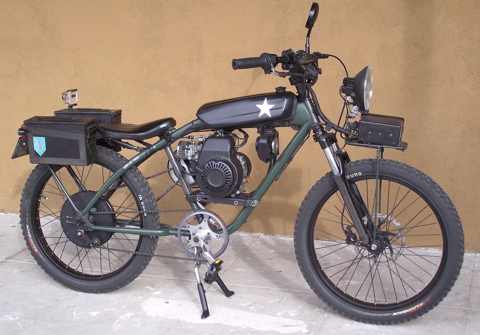

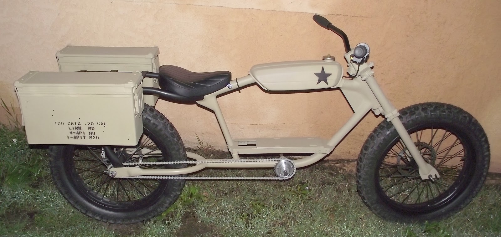

LMAO I needs range and I needs that range stuffed into those 2 ammo cans as shown in my bike pic. I know those ammo cans look huge and they are big but they are not "lead acid" big by any stretch of the imagination.

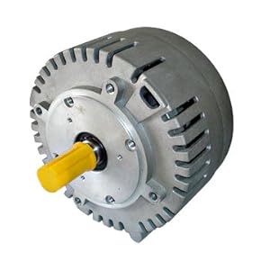

This 19 peak HP motor is designed to propel a motorcycle sized bike down the road. Input voltage of 30-72 VDC. 100 amps continuous, and up to 300 amps for 30 seconds. This motor ain't gettin' hot and I plan on breaking the speed of sound with it. There's nothing wasteful about that. LOL

Drawing over 100A's, that motor will be warm. Looks like it's built to deal with the heat, but I'm not talking heat dissipation, I'm talking about a design that doesn't generate heat in the first place.
