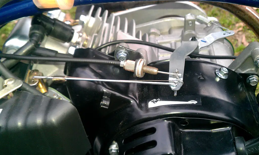

With the popularity of these lil motors gaining here, I thught I would post
about my latesy Preddy throttle control.
I did nothing at all to the govenor or linkage, but reverse the spring direction and remove the fricton throttle.
I then fabbed a bracket to take a cable socket, and saftywired the cable end to the bellcrank thru the hole next to the throttle rod. Here's a pic that shows it all.
