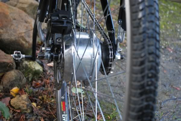

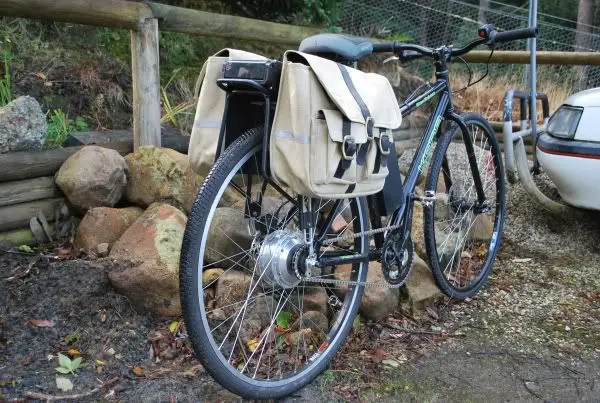

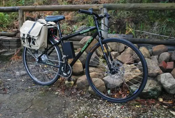

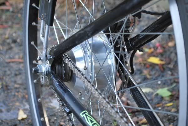

have decided to go slightly more hi-tech with a planetary geared brushless 48V 500W disc hub motor from ecitypower and a matching 48V 10AH li-ion battery, had some good results so far, absolutely kills the 1000W push trailer using a gearless brushless motor!!
Had to lace the wheel up, bought a strong SUN RIMS rhyno lite 29er rim and choose 4x pattern for a super strong wheel!!

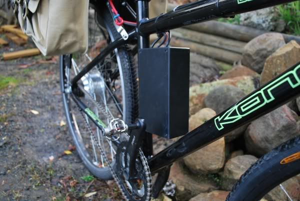

However I have had battery problems, wire from fuse to key lock was very undersize and excess heat melted the weak soldered connection and earth out the fuse (ecitypower said wire is undersize and will make efforts to tell the manufacturer), I have now re-wired the battery internals bypassing the key lock ignition and internal fuse, and now running an external blade fuse configuration, has worked well so far..
