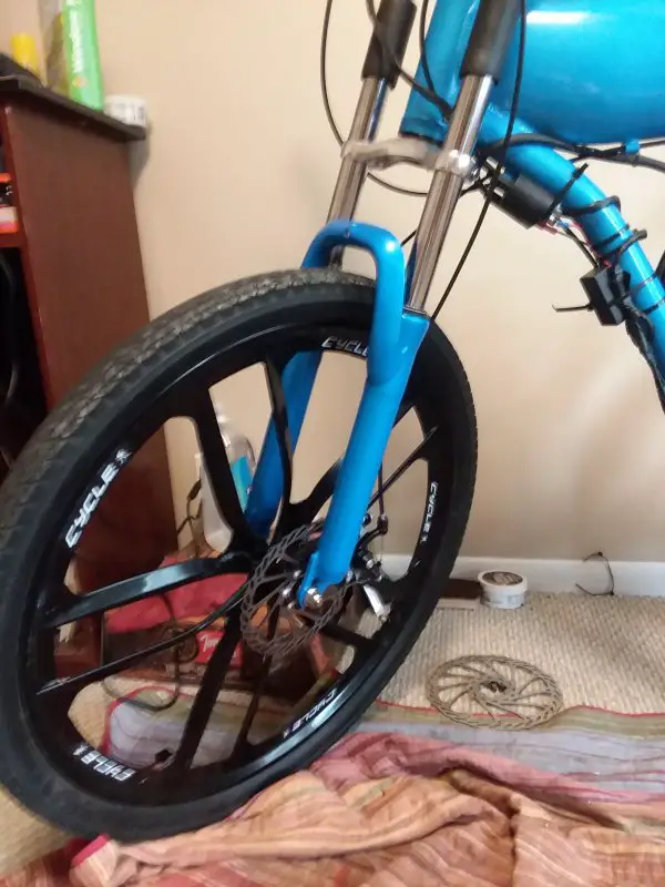

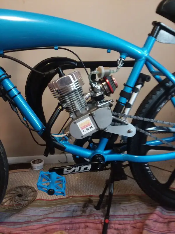

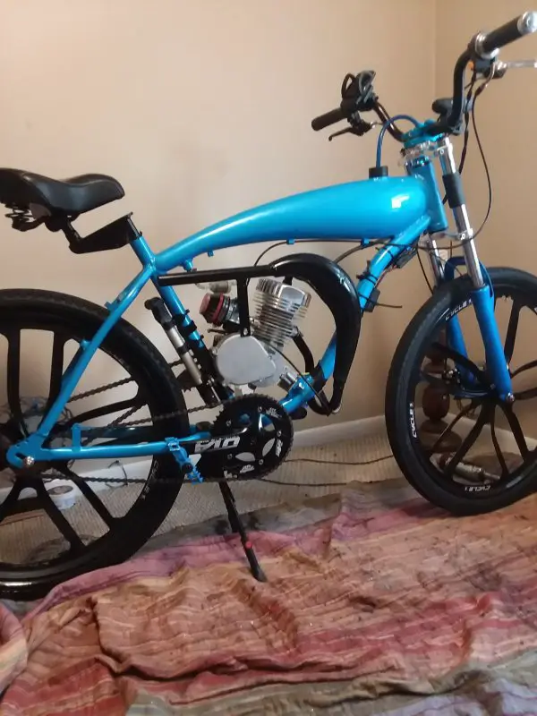

So I'll start by saying my bike is not stock by any means of the word I'll try to remember ever thing I have done: first off my engine is a pk80 race engine built by Fred over at CR machine with with that comes with a balanced crank, A generaly decent port job (I say this because he ports them for general use excellent port matching and A+ clean and professional) but there is some room for improvement depending on what your looking for so I put my little touches on it as well for a little more top end, I have a dio reed valve with a windowed a d modified piston, 21mm oko carb, all sits on a BBR TYPE gas tank frame 10 spoke mag rims, triple tree forks, 203mm disc brakes, oh forgot to mention a Fred head 6.5mm, and I run premium pump fuel mixed 50/50 with race fuel. I think that about covers the power train. But I had a 36t sprocket on and it was screaming so I decided to try a 30t for shirts and giggles and it's still screaming. I can't even go full throttle without red lining it. So I ordered a 26t this week to see what it will do. What is the smallest anyone has used with sucess?I WEIGHT 180 AND my bike just has so much power I know it can handle more. I mean as it is now I can take off from a dead stop with just the motor. It's CRAZY!!!!! THE LOCAL SHOP GUY where I live keeps asking me to let him see my ports and piston lol I won't just because the first bike I ever had I bought from him for 300 bucks was a pile of trash. The motor (older half breed)was good that's abut it I still have it on another bike. But it was on a Shwin frame and looked clean so I bought it on a whim. After I bought it noticed every bolt/ nut was stripped/double nutter both rims were bent, was missing 3 rag joint bolts well you get the picture, but that actually helped me discover how much I like working on them now because I had to completely overhaul that bike and it all started with a $50 huffy Cranbrook lol pics below of my first bike and my current bike 3 yrs and 3 builds later lol oh and it was laundry day hahaha. *pics were taken last year before last round of mods.
