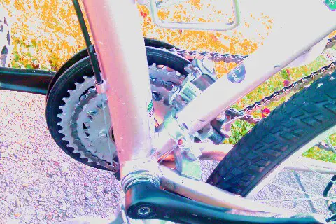

I'd contact David Staton of Staton Inc about one of his shift kits. With the SI shift kit it uses a double freewheel system. It can hold 3 chainrings instead of one unlike the Sick Bike Parts shift kit. In my SI shift kit I had double White Industries Trails freewheels installed. It comes with a 28t chain ring and I'd suggest adding a 36t and 44t steel 4 bolt chainrings. The SI SK engine drive sprocket is a 44t.
This setup gives you a 3x7 drive system. The shift pattern will work like this: 1(1-3), 2(3-5), 3(5-7). Hill climbing 1(1-3); level ground cruising 2(3-5); down hill or level high speeds 3(5-7). Center the wheel to where 2(4) puts the chain in a straight alignment. With this set up the lateral stress on the chain will be greatly reduced thus reducing chain failure. Get a good chain like a Sram 870.
The shifters put them on the left handlebar. Use a 7 speed twist shifter for the cassette and a thumb shifter for the chainrings. A little trick I did on my late brother's build was was to engrave a line down beside the shifter numbers on the twist shifter and engraved a dot beside the numbers on the thumb shifter. Then I painted the dot beside CR1 red, CR2 yellow and CR3 green. Next on the line on the twist shifter paint (1-3) red, (3-5) yellow and (5-7) green. This way you'll keep the red rear cogs on the red front chainring, the yellow sprockets on the yellow chainring and the green sprockets on the green chainring.
