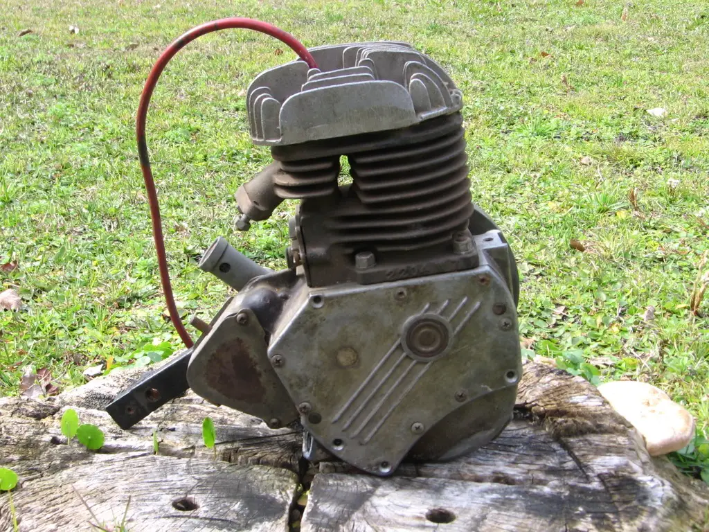

Mason_Man, Thanks for the info. Here is what I started with. Dont have current pics cause most of it is in storage.
Mason_Man, Thanks for the info. Here is what I started with. Dont have current pics cause most of it is in storage. Here is the motor before rebuild. I have the clutch Arm, just need the Pully, Bearing, clamps etc. Would like to keep the bike an affordable project. Goal is a mix of the old and new, Re-pop and origional.
You've got a really good start there, nice head, are the valves still 3/4" valves. also you can add the electronic ignition, eliminate the points.
Ray
Sounds like it's still a standard bore,they start out A, B, C, D, then go to oversize.
