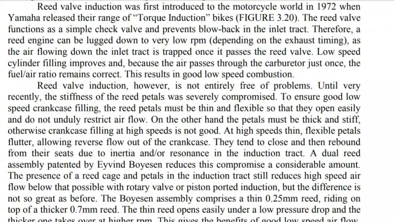

Reed story here in the picture it makes total sense

Reed valve engines have some advantages because they supply fuel/air on demand. They also have limits depending on their design and construction. The reeds can only open and close so fast and making them able to close faster also makes them open slower. Personally I prefer rotary valve or piston port engines but some people aware by them. Piston port is most simple and reliable.

To the Original Poster, a reed valve design definitely helps fatten up the low to mid rpm performance, and since these motors, (for the most part) don't spin much above 7000 rpm without vibrating or self-destructing, I'd think a reed set up wouldn't affect the top-end too much. A fun project would be a YD100 with reed set up, balanced and set up for 6000 rpm and down. You could probably pull a 32T back sprocket easily and not piss off the neighbors 3 blocks away, too. Win-win.
