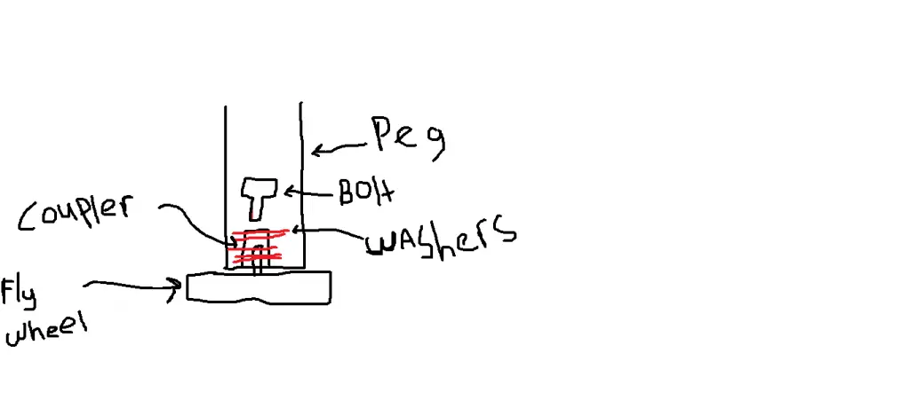

That looks like it might work good. That "coupler" you're showing- is it the square-holed thing that comes on the weedeater tapped for a bolt, or is it a female-threaded deal? If so, where did you get it? I might try that.
Just make sure your peg is about one inch to 1 1/8 inch diameter.
Its a female coupler you use to connect 2 pieces of threaded rod together. U can get them at homedepot next to the threaded rods.
