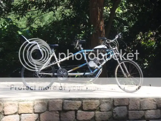

Like i said in my "hi i'm new here" post, i'm busy with this tandem. Got it running and i'm enjoying it thoroughly.
made myself a new for with some scrap metal we had at work and that has improved the handling a bit.
i'm running the 66cc kit with a 48 tooth sproket. it is very hilly here and i needed the extra power. even with the 48 tooth i often pedal had in the lightest gear.
next i'd like to get a little expansion chamber, but it loks like i'll have to make one due to budget constraints... :)

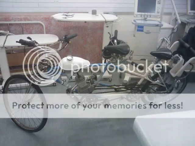

here is a pic at work last week.

thanks for the complements and i fixed the pic (thatnks for that heads up i did not realise it was not working). i want to try and put some more detailed pics up on the blog. for the last couple of things that i did.
next i need to sort out the braking. i have very little to no brakes. currently only have back brakes - i'm busy making ones for the front. will be copiing the whole v-brake design. . i have a double brake setup at the back that i will be joining together, i will also be making all the brakes (front and back)work off one lever. with the all the hills where i ride, it does become a little hairraising right now...

Love those girders! Was the round tubing "weak and bobbing" or did you come along some square cheap tubing :p
