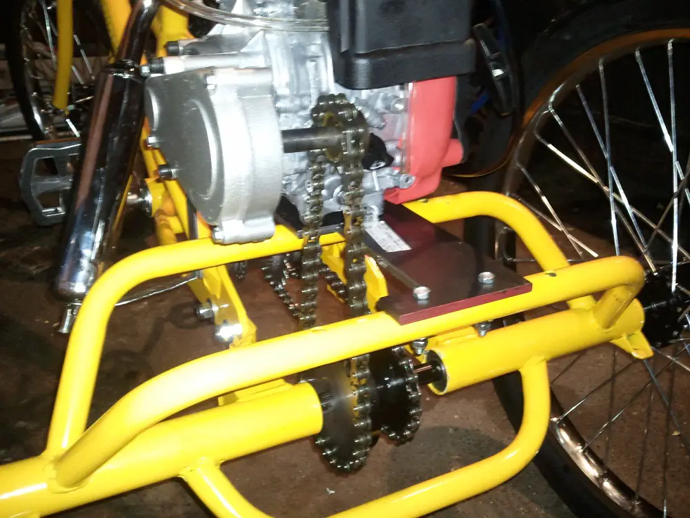

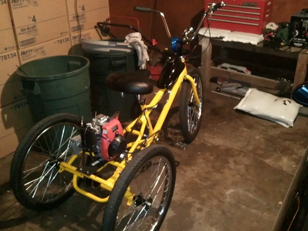

I posted this in gears and hubs, but it is a trike so I finished my 49cc Tri Rider yesterday and not surprisingly there is no low end power. I'm running a 11T drive sprocket and a 24T on the axle. (4" diameter) I know it's small, but there are three support bars in the way and the max diameter sprocket I can squeeze in there is a 5.5 inch which I don't even want to try because the improvement wouldn't even be worth the trouble. The only thing I can think of is to build a 10" mini axle off of the back with two sprockets (44T & 20t) and then back to the original axle. Anyone have any suggestions? I only need about 15-20 mph top end. Get up and go is my main priority just to tool around the neighborhood with my dog. Thanks.
perhaps try switching out that tranny for a cvt, if you can find one that will fit? I dont know if the huasheng engine will accept a cvt or not. its worth a try though.
Is that a 3.25:1 gearbox? If so, you have a 7.8:1 overall ratio right now! Assuming those are 24" wheels, the trike would go ~18MPH at idle!
You definitely need some more reduction in there. If you switched to #35 chain and sprockets, you can run up to 10>44T, tho you'd lose the freewheeling.
That will give you 14.3:1, or 10MPH @ idle. Like you said, not much of an improvement, since you'd be going 30MPH @ 6000.
That's the same as top gear on my own build, and I can't really take off in that gear!
Using your existing gearing, you can also do this by switching to 16" rear wheels :p
If you were using a 4:1 or 5:1 gearbox, you'd get closer to the optimum reduction for your setup, which I estimate about 18:1 overall.
With a 4:1 gearbox, you'd need 45T on that axle; with a 5:1 36T. Closest to your existing gears is 7:1 and 26T.
