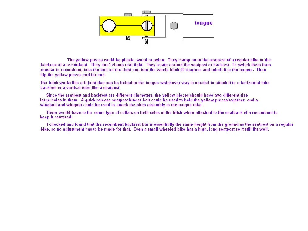

Below is my version of a hitch that works like a u-joint and adapts to a regular upright diamond frame bike or a recumbent. Click twice to enlarge text to legibility. If you have no need to accommodate a recumbent the yellow portion could be one piece. Two pieces are necessary for a recumbent seatback which can't be inserted through the hitch like a seatpost can.
If you insist on 2 or more trailer wheels, any simple hitch will do that flexes in all directions, so the bike can lean independently of the trailer. This could be a piece of tire sidewall wrapped around the seatpost and bolted together, then bolted to the tongue. You could use an air hose quick coupling or one of very many hitches from bike & motorcycle trailer plans you can Google or find with a search of this forum.

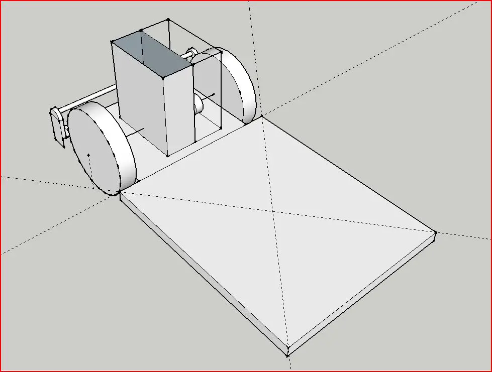

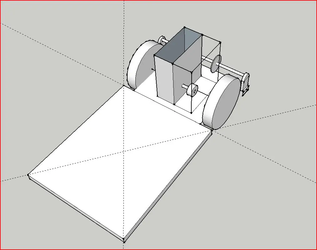

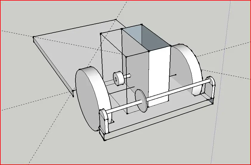

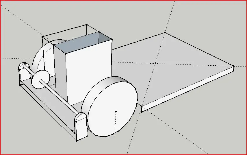

Alright, I took apart my tack welds and ground it back to just metal stock for the frame. Attached are a few sketches of what I am shooting for now. The upright box on the trailer is the engine while the wire framed area next to it just shows where the sprocket/ belt drive will come off the engine. You have the drive shaft off the engine as well as a centrifugal clutch. The bar on the very back is a jack shaft running to sprockets on the outside of both wheels. The reason the engine is centered between the tires is because it is a heavy engine and I would like to keep as much weight off of the bicycle as possible. the cargo area in front of the tyres is 3.25' by 4'. I still haven't figured out yet how the trailer will hook to the bike, but I figured this will give you all an idea of what I am shooting for. It is mocked up with 20" wheels. The engine weighs 121 lbs.
