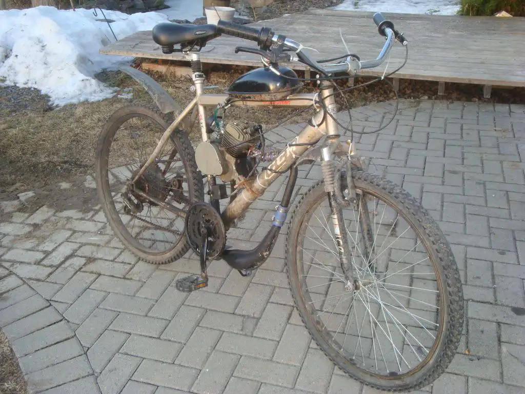

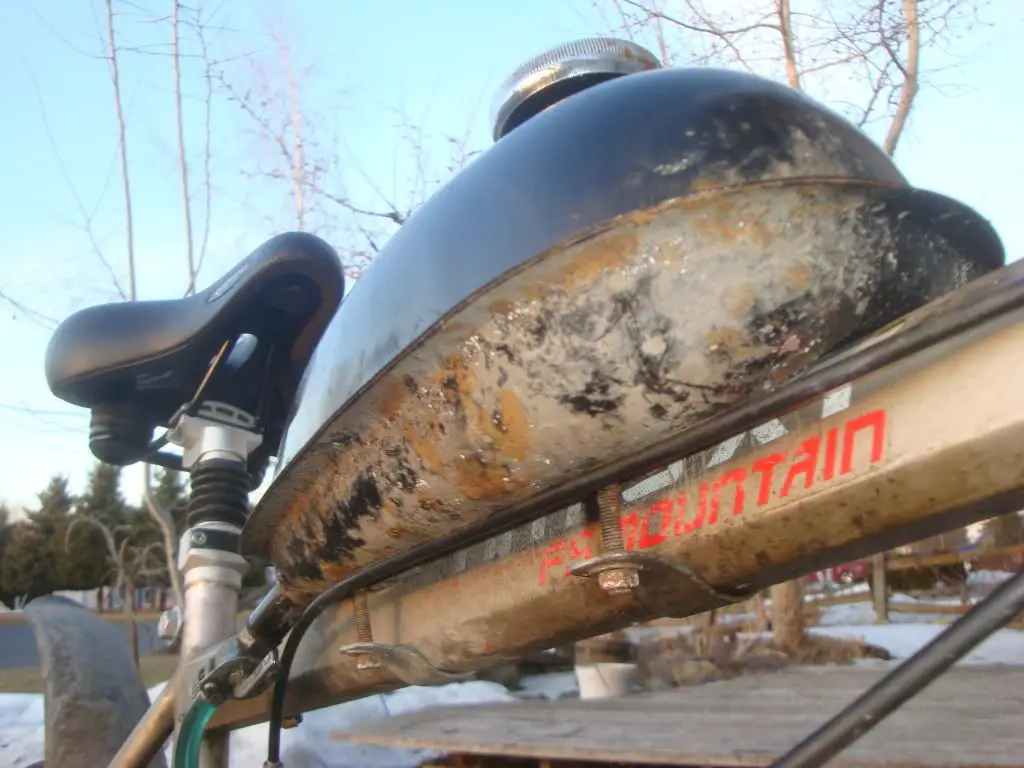

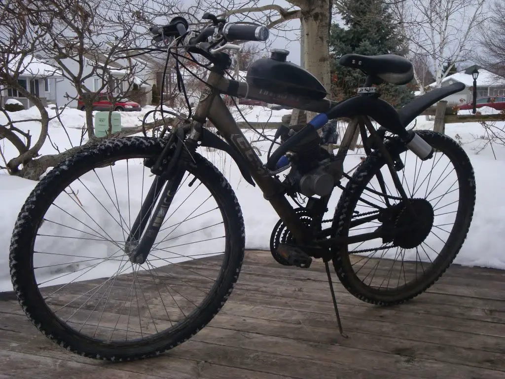

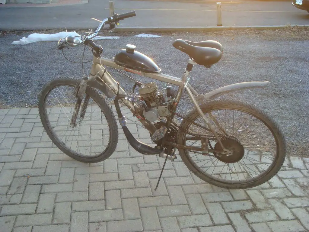

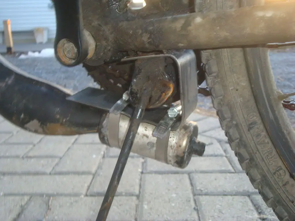

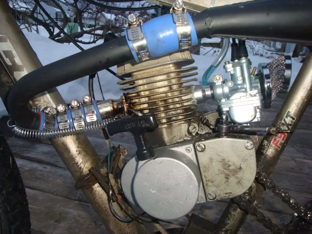

here are a few pics of my bike! yes, i did feel the need to use 6 pipe clamps on my slipjoints... lol

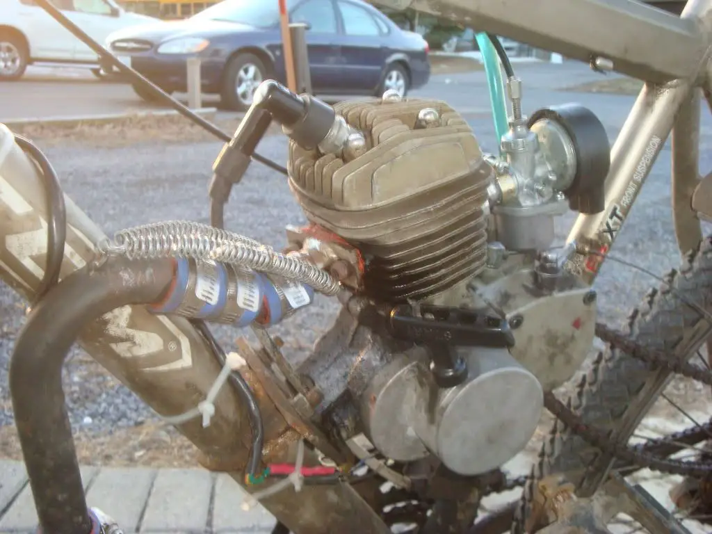

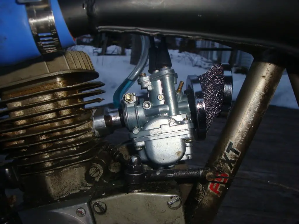

CNS carb installed on a CNC intake tube, pullstart, NGK wire, cap, and plug, SBP pipe mounted upside down, Serfas nuthole seat on a suspension post.
as far as little issues to correct, i have to tap threads into the CNS carb's top to install a cable adjuster on the throttle hole (there isnt one, i have at least 1/2" of freeplay) the clutch lever is sloppy as **** so im putting an all metal one on i got in another kit, i have to adjust the idle screw and mixture screw on the carb. wont idle when its warm, hard to start with the yanker... lol
oh ant the exhaust gasket is leaking a bit.
anyway enjoy, comments welcome! BTW, i believe the crud on my bike is a sign of character and soul, no i wont wash it
