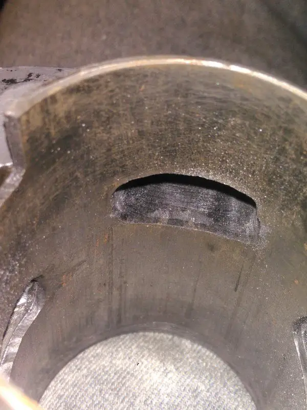

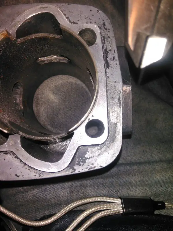

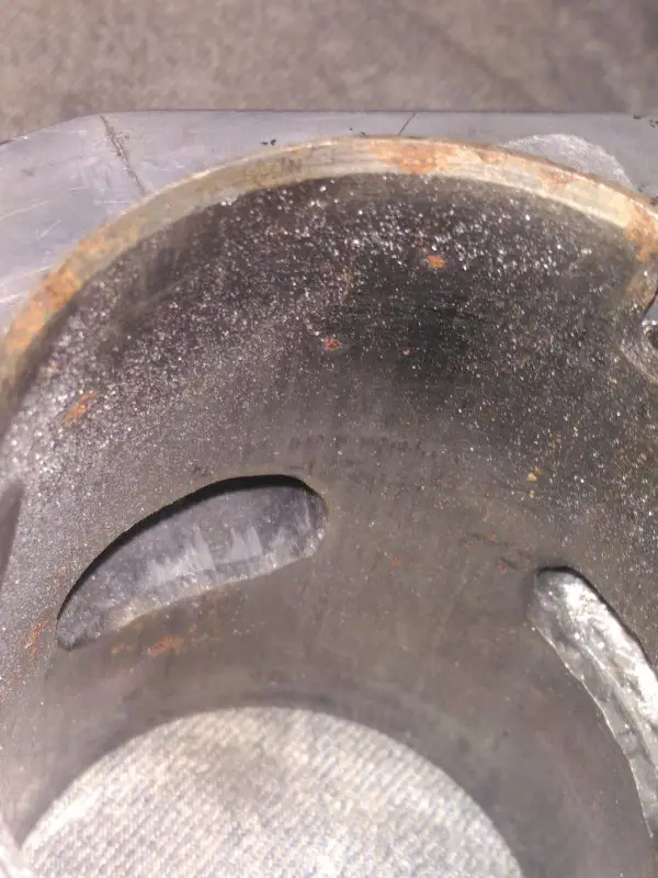

MOST OF These are the regular China doll "80cc" motors that they build with just a @2mm bigger piston and usually a honed out cylinder which makes the sidewalls thinner. ONE OF THE ONES THAT I GOT WAS SO UNEVENLY HONED OUT THAT THE BOTTOM SKIRTING HAD BEEN GROUND THROUGH.(see photos for example. If you look closely you can see the difference in width of the sidewalls of the cylinder.)

This comes after me port matching using a G4 ld100 cylinder with a CNC high compression head on a yd100 bottom end that I replace the bearings and the seals. (See photos)
Yes there is an increase in performance and power but it is not enough to compensate for having to order special sized parts for the larger Ld 100 cylinder. Gaskets, cylinders ,heads, piston, piston rings, wrist pins, wrist pin needle bearings, carb jets...
Much less an exhaust pipe that is wide enough to match the cylinder. The side walls on the exhaust port on the cylinder are 3.2 mm wide in some places making it impossible to get a good seal without using metal putty to build up the area surrounding the exhaust port.

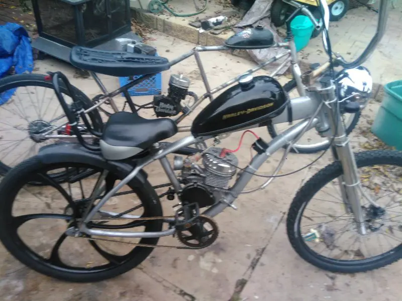

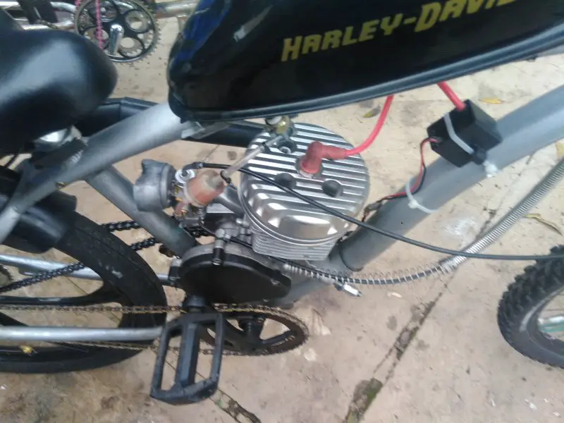

And on the positive side of having one of these is it looks cooler because it's 1/3 bigger and it's louder and sounds better but that's the only positive things I can note. (See photo 4)
