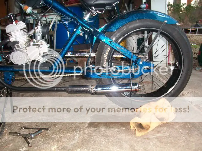

bought the livefast pipe last night on ebay and then got an email today saying they are out of stock for 30 days and will refund my money..guess i will cut the barry pipe and weld the stock muffler onto it.

the pipe is welded to the muffler..i figured i could cut off leaving a small stubb..stubb is a little smaller than the barry pipe so i could just slip the barry pipe (after i shorten it) over the stub then weld them together.
i want an all chrome pipe so this will have to do till livefast gets some pipes in.
well i cut up the pipe and and welded on the muffler..to get it the right length i had to leave some of barrys bigger pipe and welded the muffler to it..inside barrys pipe was some washers right at the transition from the little to big pipe...i used a long drill bit and opened up the hole in the washers as much as i could..so now the exhaust goes through the little pipe hits the washer and into the bigger chamber and then through the muffler..it actually sounds pretty good and revs real good...here is a pic,i will build a mount strap this week as well.
