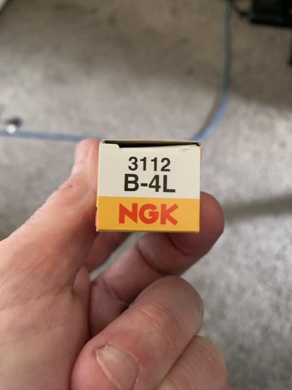

Hi everyone. In the last couple days, I've noticed what I can best describe as a "clinking" noise when it idles or when I try to ride. When I try to ride it it struggles and can barely accelerate. Doesn't even have 5 hours run time on it. It's running 40:1. I'm going to check everything I can as I want to break it in properly. I'll post of a short video later today of it idling so it can be heard. Here's a pic of the Plug that's in it now. Not sure if its considered an normal noise with the stock china doll motors?

NO that's not a normal noise or symptoms.
Rusty your S/P NGK B-4L has too hot of a heat range (#4) and is causing a pre ignition Knock
The fuel air mix igniting before spark @TDC because of a hot S/P electrode, robbing your engine of power You should be using a NGK S/P with a #6 heat range.
The lower the # of a S/P the hotter it is.
Use NGK B6HS
Ok. If I remember right I had Autozone look up that exact plug but the only result they got was the one I bought. Would I maybe have better luck at like oreilly or carquest auto parts? As for the oil mix, soon as my gas can is empty I'll switch to 32:1 and try that.
Ok I ordered 2 of those plugs on Amazon so I have an extra. When I get them I'll put one in and let ya know if the motors running better. Thanks again.
