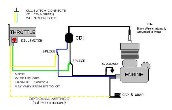

what is correct wiring then blue to blue and black to black. kill switch not hooked up.
Have a look at the attached diagram.
Why are you not using the kill switch? It's a very good safety feature.

Oh hey Tom, thanks for reminding me I updated that pic for less confusion with the ground, and having to say "Ignore the optional part"

KC,
That's the way mine was originally but there was always questions about the white wire and those who advocate using it in the kill circuit. Also the ground. People didn't seem to understand that the engine is grounded internally via the black wire. That's why mine was changed. The important thing is; blue to blue and black to black and how to connect the kill switch. Both of our diagrams get those points across.
Thanks.
Oh yea, for sure. I was just trying to simplify it back... and save people from duress. The white wire kill will work, I used to have a bare wire on my handlebars, once it was wet though, it gave me a good zap, so I started promoting the bla/blu splice kill, lol, woo too no zap!
Love it or hate it, the graphic works, eh?
