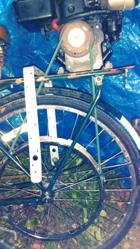

Not trying to forum Jack but what's your opinion about on adding coil overs under this set up where the two big holes on the lower rack are.
I currently have an issue with a slight wobble at times from the rack not being fully stout supported?
Look for the green hole toward the bottom wheel. View attachment 96098
can't see a 'green hole', but I think I'd just attach a piece of pipe to chain stay and seat stay (like an arc tensioner is attached), and then attach that pipe to mid point of the flat legs of the motor support - should stop wobble OK
I'm a bit frame name illiterate chain stay is the opening where the wheel slides in right?
Seat stay is where the seat post is?
Sounds good, also if you look at the piece of bracket That's between the seat and motor that is not attached to the bike on one side look at the back side of the wheel where the bracket ends, that is the two open holes I speak of.
There is one on both sides of the rack but I do like the chain stay idea... except probably would prefer to weld or precisely drill two holes per side on the back of the back bottom side of the rack and add on to extensions commonly referred in the moped world as shock extenders.
That way it would be a solid mount point. If applicable could also add two more to the stays so the motor vibrations won't widen the holes over time.
I'd prefer aluminium at the point, to prevent access weight gain.

chain stay is the horizontal pipe from the dropout (where your brake arm is attached) - seat stay is the pipe coming off at an angle from the dropout to the seat - these are thin and clamping to them would be better than drilling
