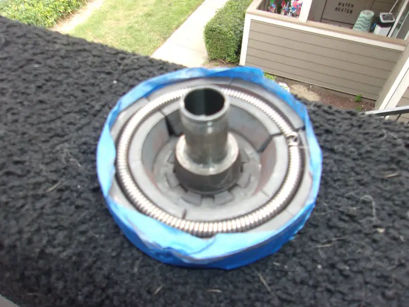

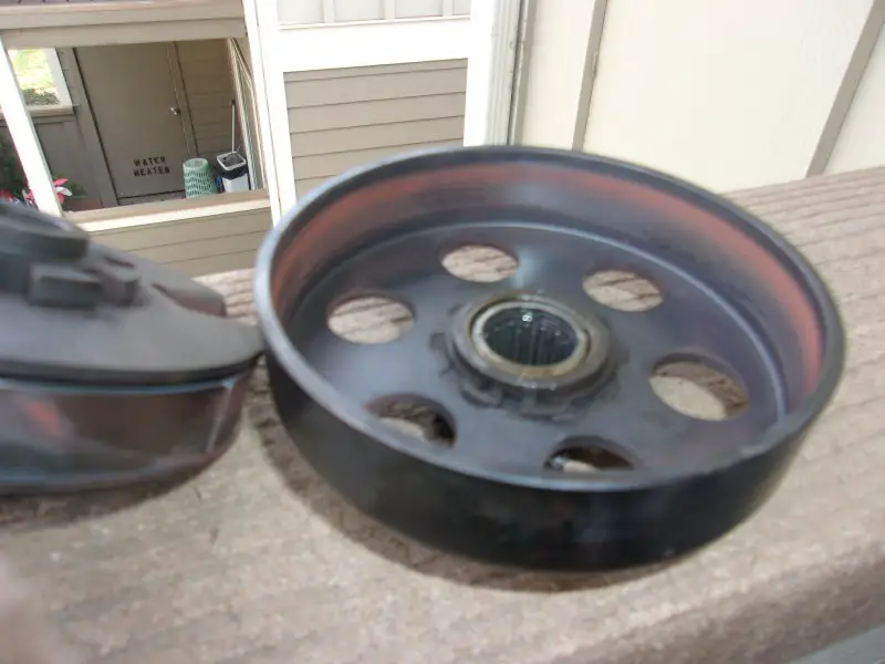

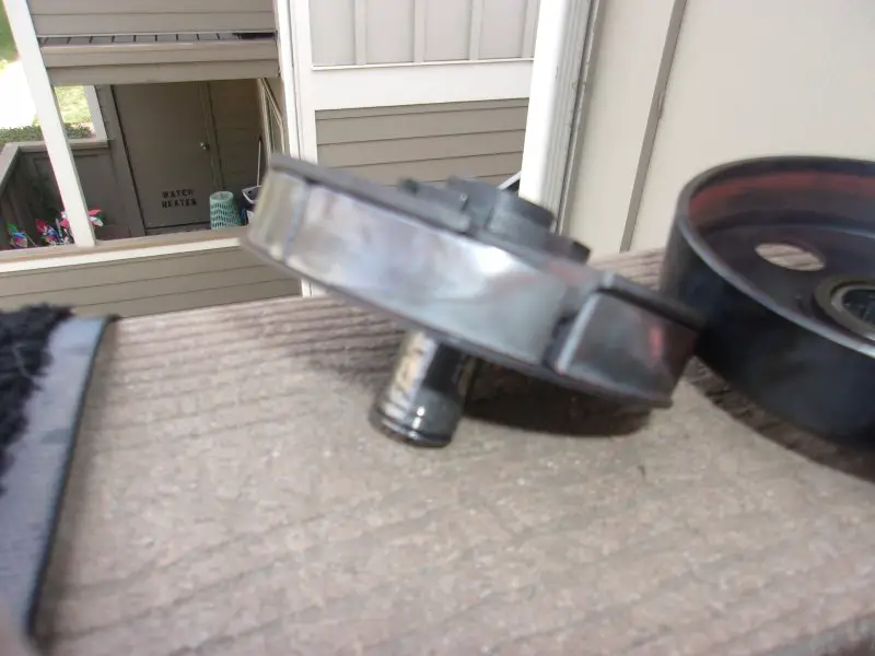

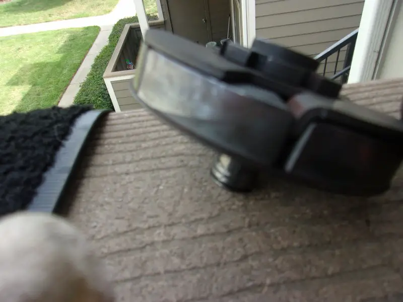

Never once have I noticed any clutch slippage but I always thought they had some kind of material on the puck things not just metal to metal. So I am wondering is this one okay or trash? works fine as is but in pics you can see what looks kinda like silver paint that has worn down to metal and at best it was the thicknedd of a coat of paint. Thanks for any and all help, PeteJ

Those are not Organic clutch shoes
Those are Sintered clutch shoes and their fine,
Their suppose to look like metal because Sintered shoes are metal
Thanks and thats what I just found out in video and never in my life have I seen a clutch like that that doesn't have some kind of material on pads. Kind of a bummer that I didn't find this out till after I ordered a new one but good news is now I have a back up(^)
Max Torque Made in USA Sintered is of the highest quality
BTW M/C and Bicycle disc brake pads also come in Sintered
