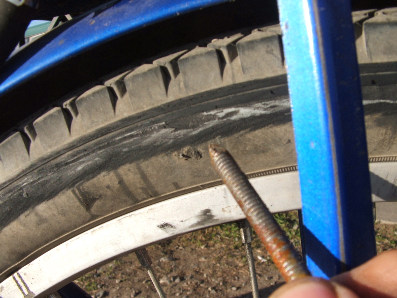

Update. The drive chain was so perfectly aligned, I was too happy to think about it rubbing my tire at speed. Now I will re-fit the kickstand bracket to allow for my tire to shift slightly forward on that side, moving it over, and clearing the chain.
Trey,
Keep in mind that if you angle the rear wheel to get chain clearance to the tire you'll ruin that perfect chain alignment from sprocket to sprocket. Ideally the sprockets, drive and driven, should each lay flush with a straightedge laid against them. Angling either one will eventually cause chain problems, wear and possible derailment.
I'd look for a better way to get the chain away from the tire.
I agree Tom. I've been getting about 2mm extra clearance this way, and it looks to be very close to aligned with the drive gear. This has been a concern of mine since I got the cruiser- barely clearing the tire, and not having that chain as perfect as possible. Do you think removing the band brake will allow me to move the gear out on the hub?
