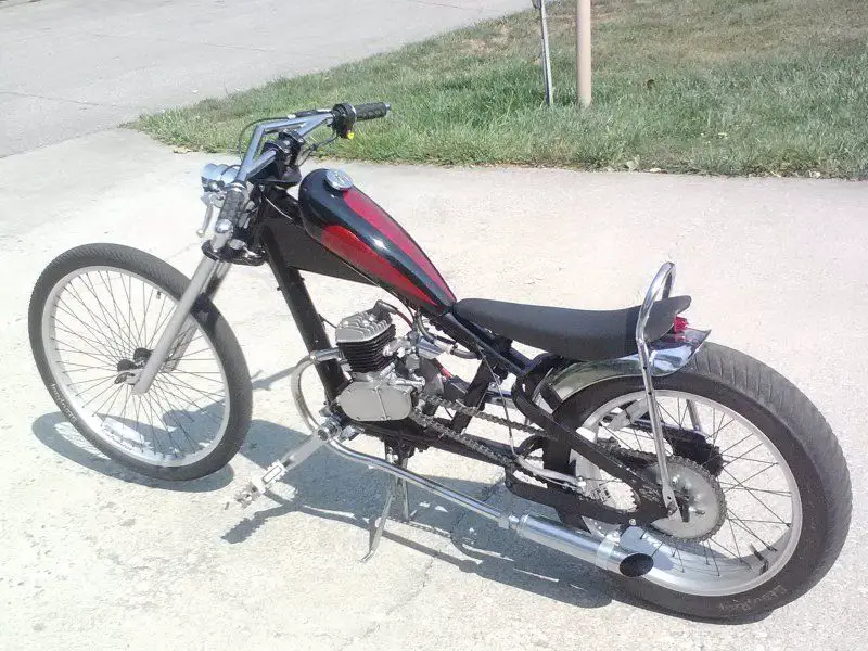

I picked up one of these tanks off e-bay for $10.00 and I have about 40 hours of work in it including the body work, paint job, wetsanding and buffing. This is the third paint job that i've put on this tank.
what i started with.
what It looks like now.

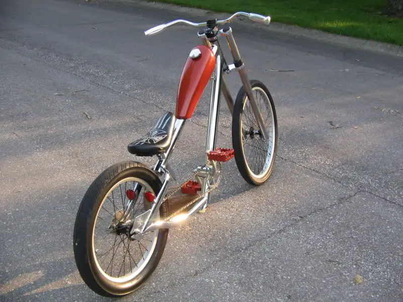

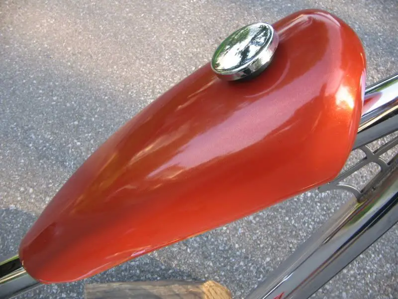

here's a jesse james bike that I got awhile back. I did the same thing to the gas tank (except i didn't make it functional). I painted the tank metallic orange laquer & clear coated it.
I added a 24" occ front wheel & tire, re-shaped the seat pan to make the seat lean back a little, added a set of billit aluminum hand grips, and put on a 20" coaster brake rear wheel (mine came with a 20" freewheel that was bent) and a smaller front sprocket to make it super easy to pedal.
I got this bike for $30.00, re-built it, cleaned it, painted the tank and added about $50.00 worth of parts & sold it for $300.00.
