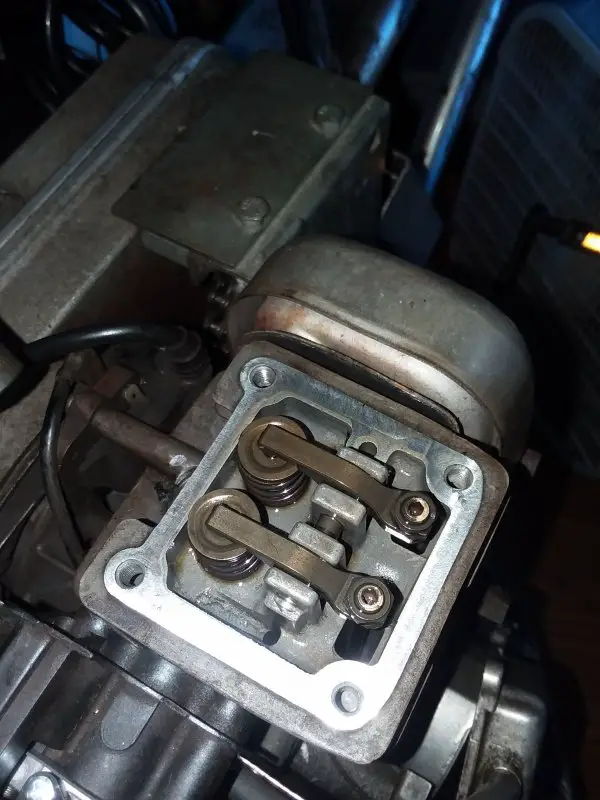

So my next thoughts were about the valves. Sadly, I couldn't find out much about adjusting the RS 35 valves, nor was there anything about any special markings for top dead center.
Finally I managed to find two adjustment settings recommended for the RS 35 valves. One said to adjust both intake and outtake to 0.15mm. The other said to adjust the intake to 0.13mm and the outtake to 0.17mm.
After checking the valves both were below 0.13mm. So I went with the 0.13mm intake and the 0.17mm outake.

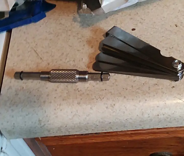

I did have to buy a 10mm top dead center tool and a set of feeler gauges.
The feeler gauges didn't have a 0.17mm. So I combined the 0.13mm and a 0.04mm to do the outtake. The feeler gauges are held in place by a screw therefore it was no problem to put the 0.04mm and 0.13mm next to each other. You'll also need a 8mm wrench and a 2mm alan wrench
Now the engine is running better than ever, even though it's over 10 years old.
