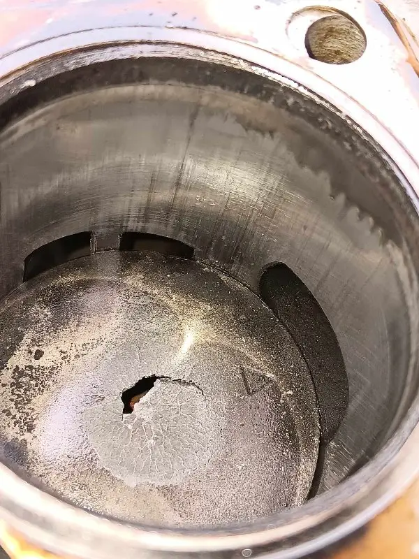

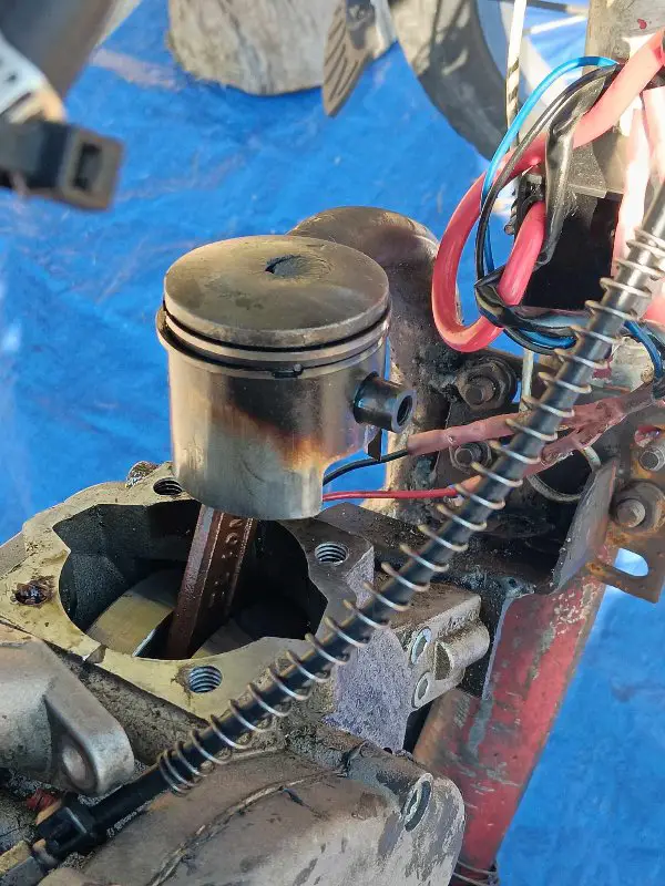

d) What about compression? If a gasket is blown, there's majorly air leaks, may not be sufficient compression for combustion.
Loose head bolts can cause loss of compression, loose carburetor = no fuel input.
Avoid trouble, do yourself a favor: No duh! check and tighten everyhing before beginning trip.
Beyond these fairly quick and easy-to-check items, it's possible having engine damage beyond quick/provisional repair on roadside.

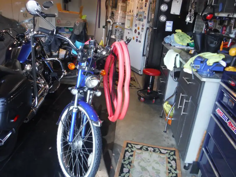

FLAT TIRE is #1 reason for breakdown, your not going anywhere with a flat tire

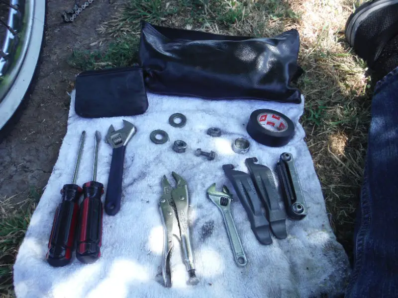

Carry tools, at least 1 tube, patch kit and a small hand pump
Changing a flat on the road SUCKS
Best flat protection I've found is Tannus Armour
Since I installed Tannus Armour 3 years ago I haven't had a flat since
I also put Tannus Armour on my Fat Tire E bike
BTW the best deal is on AMAZON - Bundle deal tubes included
If ya do get a flat, having a center stand makes taking a wheel off easy
Before I got Tannus Armour I used to get flats a few times a year
