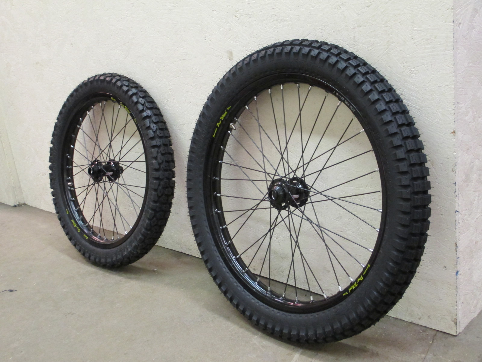

Those Shinko tires start at 2.75" and go up from there. My Razorbacks are 2.6" and I can go no wider in the front or back tire. 2.6" leaves me 1/4" clearance on both sides.
The Shinkos in the pic below are DOT Knobby motorcycle tires and those are the pinnacle of comfort and shock absorption.
