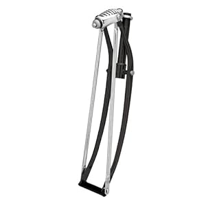

and it begins! once the springer fork comes in, i'll start the painting process.
did i mention the "druid" ($100 bill) green version was $50 cheaper?
