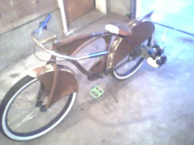

so i built this motorized bicycle, only to steal the engine for anther project, but i plan on finishing it, so heres what i have so far. its a huffy cranbrook. i used sheet metal to skirt the fenders and then added sections to the frame to make it look wavy i guess. i dremeled most, but not all of the paint, and used a heat gun to heat the paint up and then i hit it with a chemical process that rusts it instantly. choped the seat post off and found a well weathered schwinn spring seat and its held to the frame with a pipe clamp. the axel mounted engine worked well, and i might still go that direction, low center of gravity, and it dosent stick out farather then the bars, and it will not hit the ground, if it did i would have other things to worry about. and its on the side with the kick stand so its very stable. this thing did 25mph easy, with the gx35 motor on it, and i dontthink i have completly broke it in yet,
i may put a in frame kit on it, but not sure
