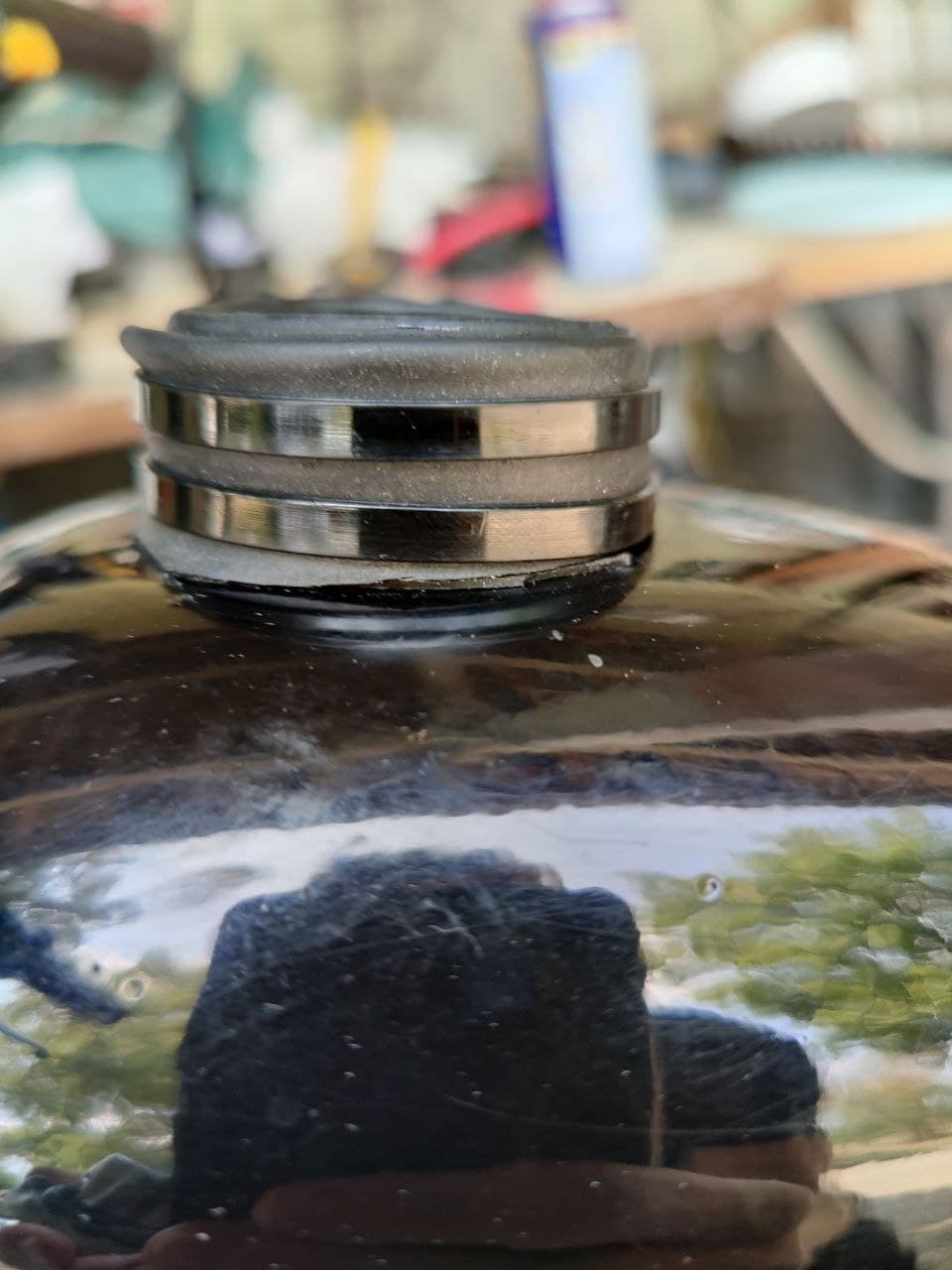

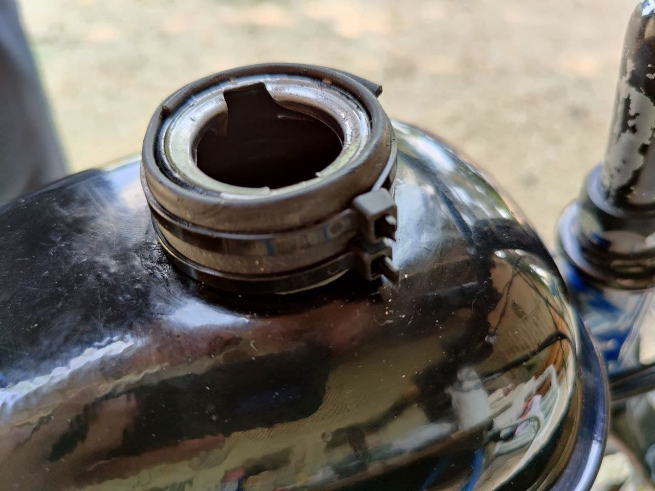

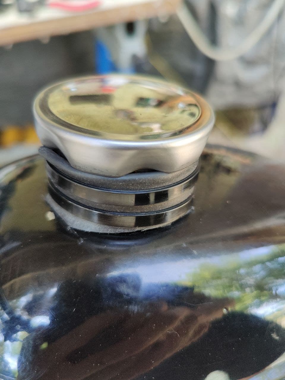

When my fuel tank is full it usually leaks lots of fuel out the gas cap area. I found a way to stop it from leaking. What I did was get an old inner tube, cut it to size, wrap that inner tube around the stem of the gas cap area, which I had cut in half (otherwise it would have been too wide), and then I used 2 zip ties to secure it.
Here are some pictures of it :
