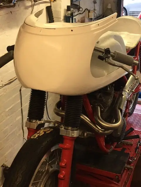

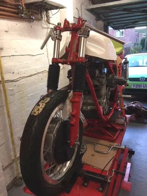

Old school clip - ons [ Tomasseli ] - old school bike.
My KZ750 60's style Cafe Racer with all the good bits - Borrani rims, AJS 7R seat base, Manx Norton tank cover, 4LS Grimeca brake, Dunlop tyres .........................
Sleeves are the answer - get the nearest ID clip - ons and fit via collar.
