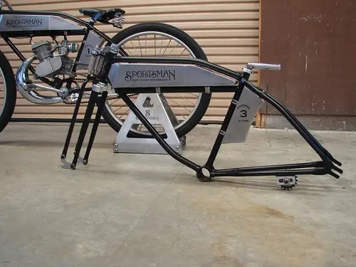

This style works best and hides well. You just flip your seat guts (clamp) and then you don't even see the layback section. Worksman is 7/8". Old Schwinns are 13/16". New bikes are typically 1".
Sportsman Flyer by Sportsman Flyer, on Flickr
