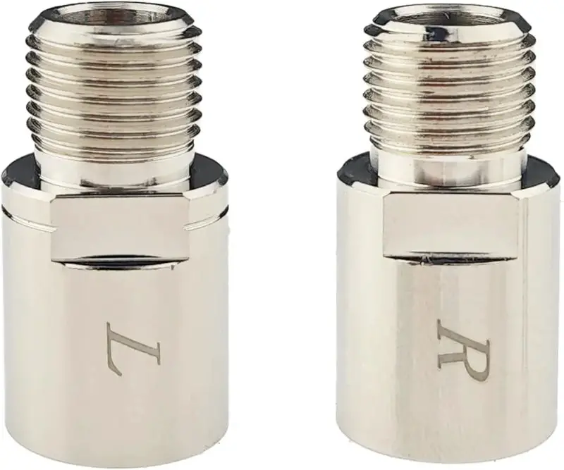

Not locating any ideal pedal shaft extension kit, another potential method of extending crankshaft using adapters as pictured has possibilities.
Basically, something needed that would fit end of pedal crank shaft, extening length of shaft, and have correct end pedals could fit into?
If commercial product, for whatever reason, wouldn't fit, one could locate correct threaded coupler/bolt combination which could be cobbled together.

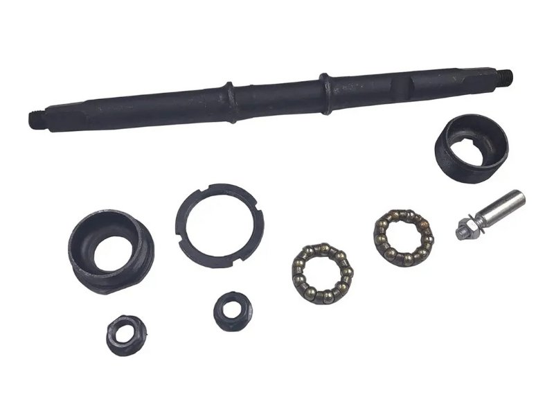

Took a look at crank and pedal setup on motorized bicycle. Was hoping for 3-piece crank, because that would be the easiest to work on, modify & to be used with shaft extensions.
Welding extra length on shaft would be saving me some time, money & having to wait for parts, thereby avoiding time spent trying to figure out what shaft extension kit would play nice & actually fitting what frame set-up bike's using.

One thing I've been able to determine for sure: quite a bit of clearance is needed, provided by shaft extension to prevent pedals striking pull start kit, which arrived via post today.
With different accouterments already welded into bike frame, I'm not having any current clearancing problems nor parts shifting about, but definitely shaft will have to come out an inch and a half or two inches to be able to clear everything pedals could whack, if adding kickstart and pull start kit.
