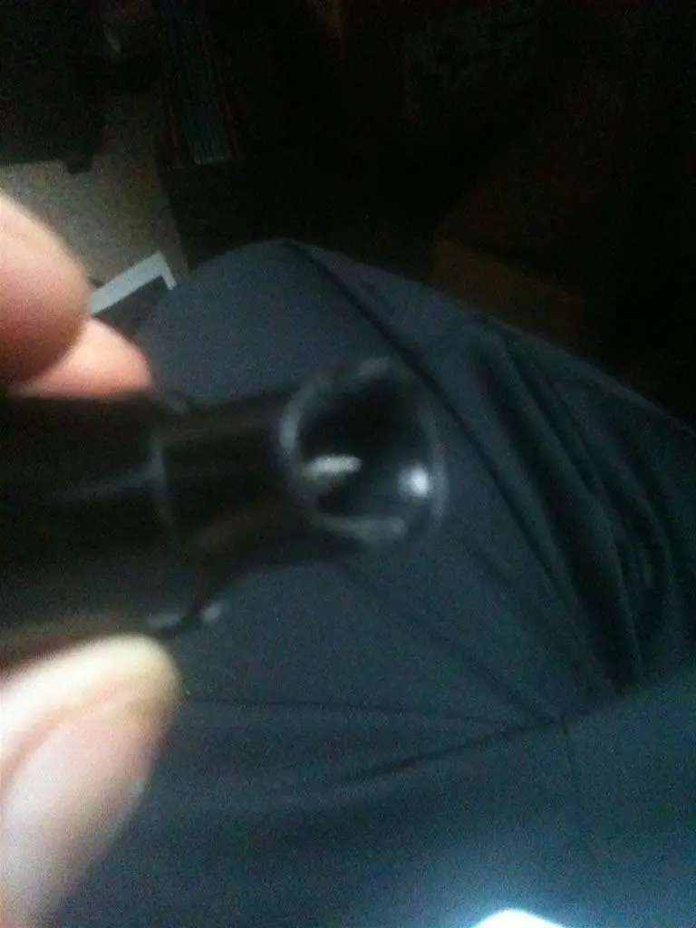

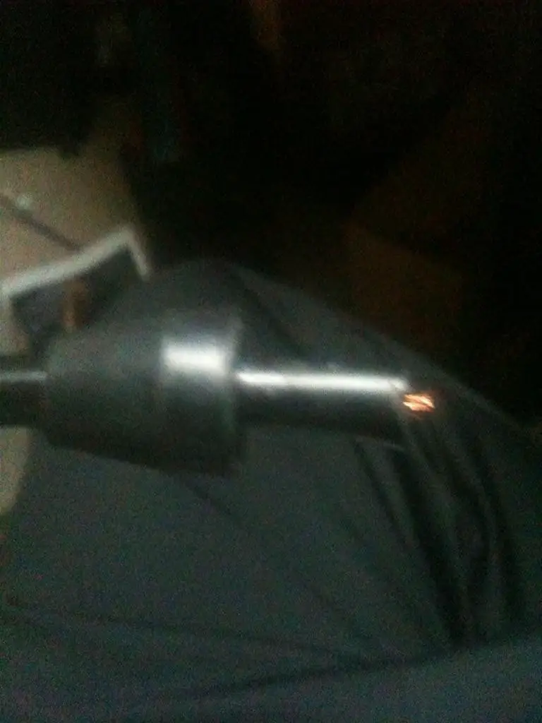

Noticed the plug boot connector was loose. Once I unscrewed it, the wires basically looked all torn up and the boot end (not the boot connector itself, but the screw side) was broken partially off as well. May have mangled it a bit more doing such, but also just looks like it never was wrapped well (or at all?) to begin with. (saved pics on that)
Looking to see if I can re-fix this now (I know there's stuff on it), but otherwise next up is getting a new boot connector...elsewhere. One busted/poor part from BGF is one thing. 2 now means I go elsewhere...
Well, found the multimeter and got readings on the spark plug, so that's likely out.
Tried just the boot plug/wire itself, seems OK.
Couldn't get anything with the boot plug screwed into the CDI box. Seems to maybe be the culprit. Will have to double-check the magneto to be sure...hmmm...

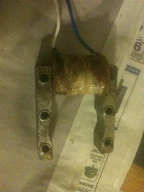

Yea I wasn't too happy with that either once I pulled it out. Although I did spill some fuel that leaked down the top & in that front end area, so it's possible some may have seeped in through the gasket & sat there for a while before drying out (which would then make that seal/gasket area piss poor as well...can't win there either way). Again, I threw the multimeter on the wires and got similar-type readings, so no breaks or bad solder joints there that I could discover.
CDI kit (with wire/cap together) I ordered from Piratecycles on here as it's pretty close to me. If they shipped it out Friday, I'll see it later today. If not, definitely on Monday so either way I'll be hooking it all up there and we'll see for sure...but the evidence points there right now.
