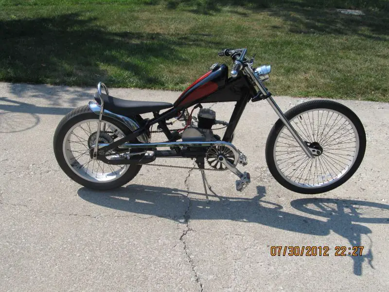

don't waste your time stripping down the engine (my opinion).
here's my occ...
