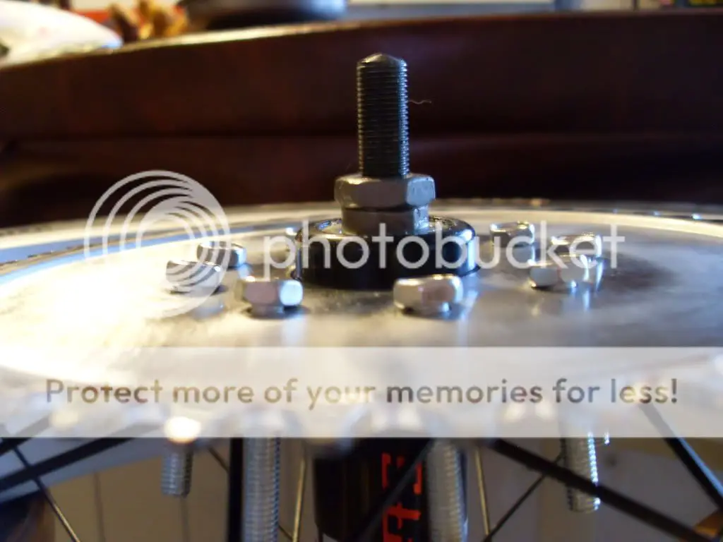

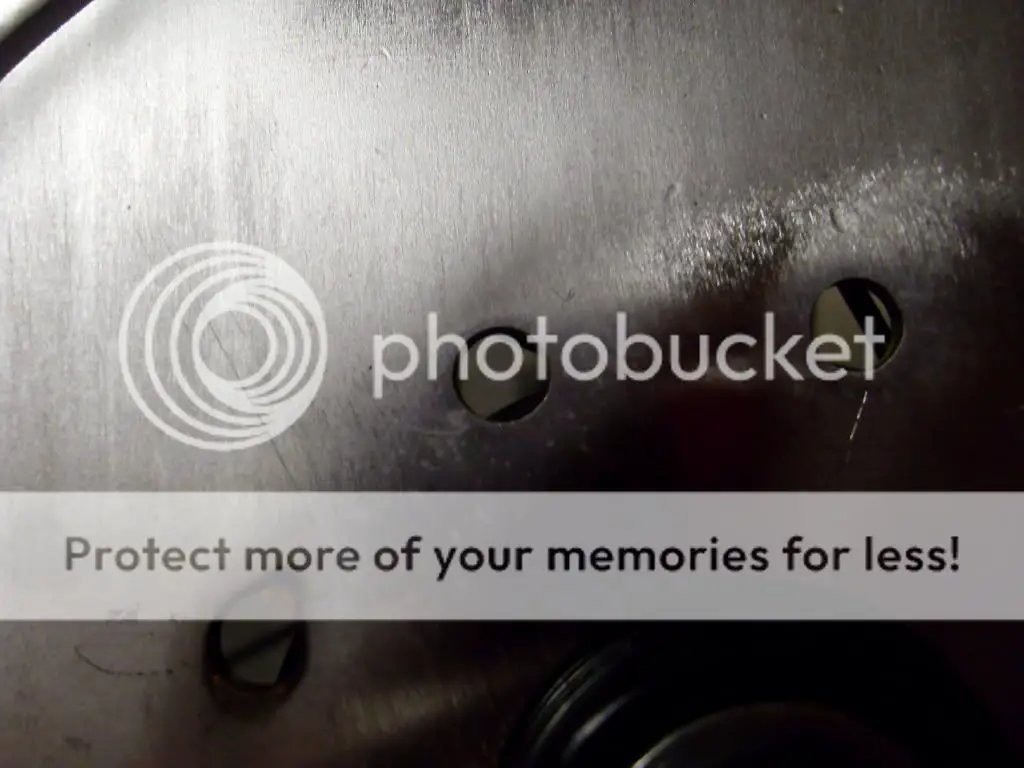

the bolt holes in the sprocket dont clear the hub completely they sit wrong...
give me a few ill take a picture or to to better explain.

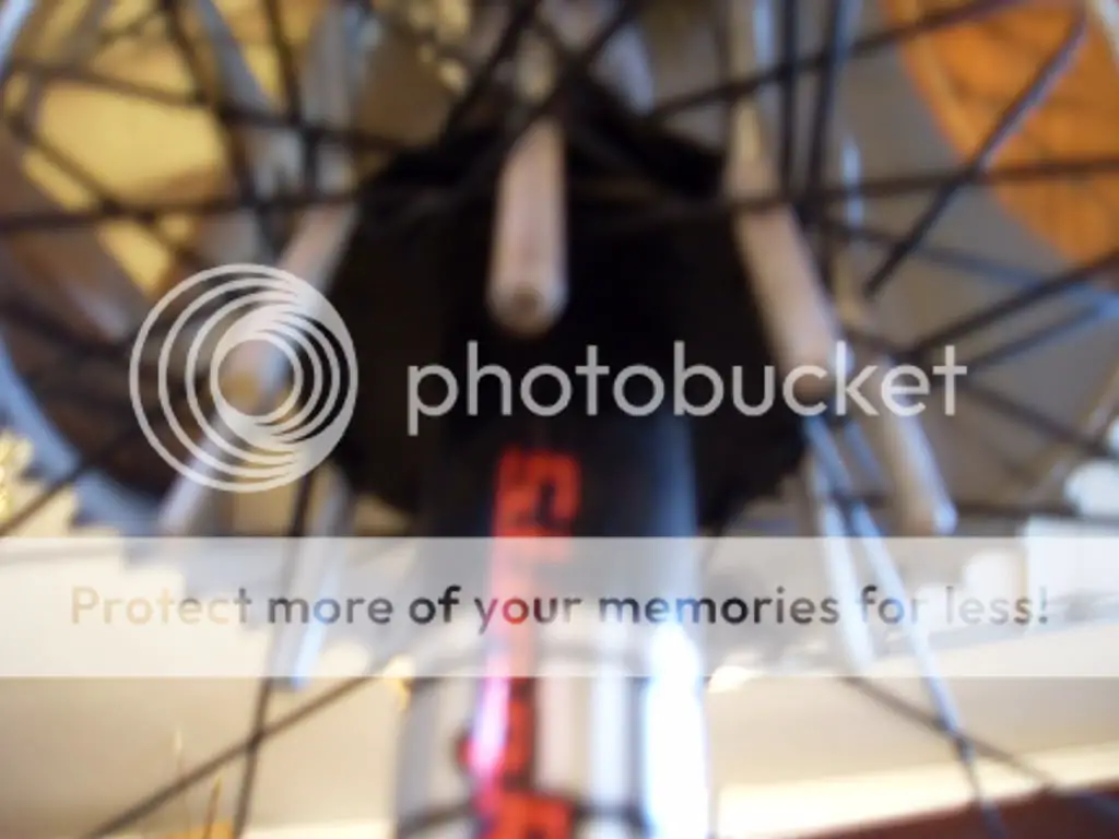

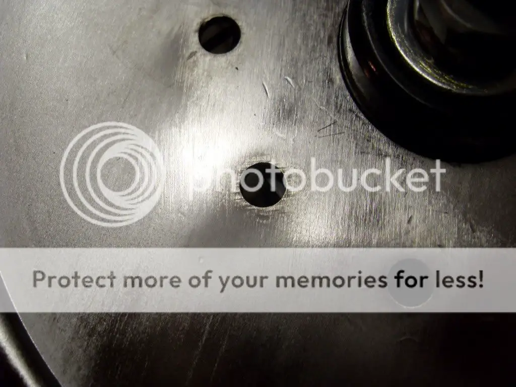

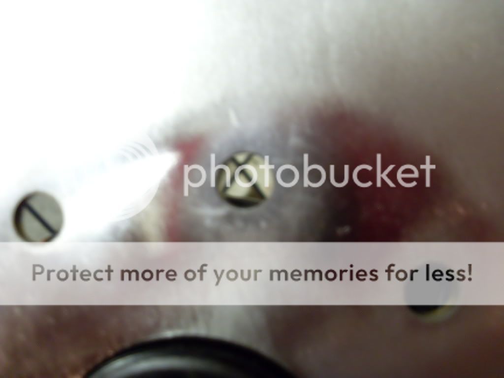

alright here are some pics of it. in my reading some people have luck some dont but my only thought would be to take about 1-2mm off the hub to make it clear but i was looking for other options.
I went to look at the s-ray wheel. It is not on the bike right now as I went to five speed. As I looked at it I remembered that I had a tight fit with the bolts!
However I was able to make it work and to my amazement it was running true!
You could take a dremel to it but I would give it a very good try first.
Good luck.
Russ
Can you elongate the holes in the sprocket and the 3 metal pieces on the inside of the rag joint? My sprocket on my cruiser has holes that are elongated from the factory.
I don't think you will have to touch the horseshoe or rag material. A rat tail file, chain sharpening file or dremel should work on the sprocket(it is not hardened).
Most important, keep it as true as possable while tightening the bolts. Also be sure to check the sprocket teeth, they are usually just punched out. The teeth may need to be tapered, do this befor you mount it.
