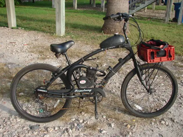

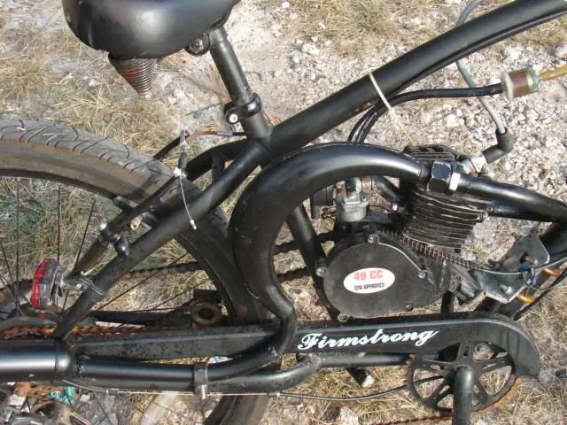

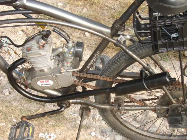

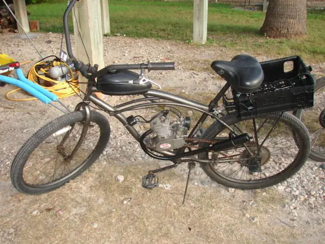

Finally got my new 80 amp HF inverter welder going....My welding skills have gotten rusty....Modified the exhaust on my friends bike and mine....
There's nothing that can't be done now......
