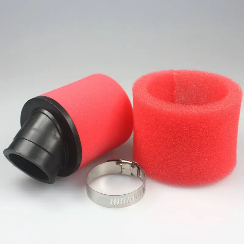

There's a bunch of air filters available for those carbs. Find a free flowing one.
You can run it without one, but you risk sucking up dirt and water, which can clog your jets, or worse, if you ride in dusty, sandy areas.
Jetting will help if your air filter already flows good. Go smaller on the main jet, or move the clip on the needle up.
I've run a couple of SHA dellorto clones they both needed rejetting to get decent performance the SHA is the big 60mm outside diameter for the air cleaner and thee are a number of options, Ive used the wire and foam sock type of air cleaner and they seem to breathe well the picture is of a 40mm i bought for something else but ive had them for the SHA clone too amazon and shop around pictured unit was about 8 bucks.... kelly
