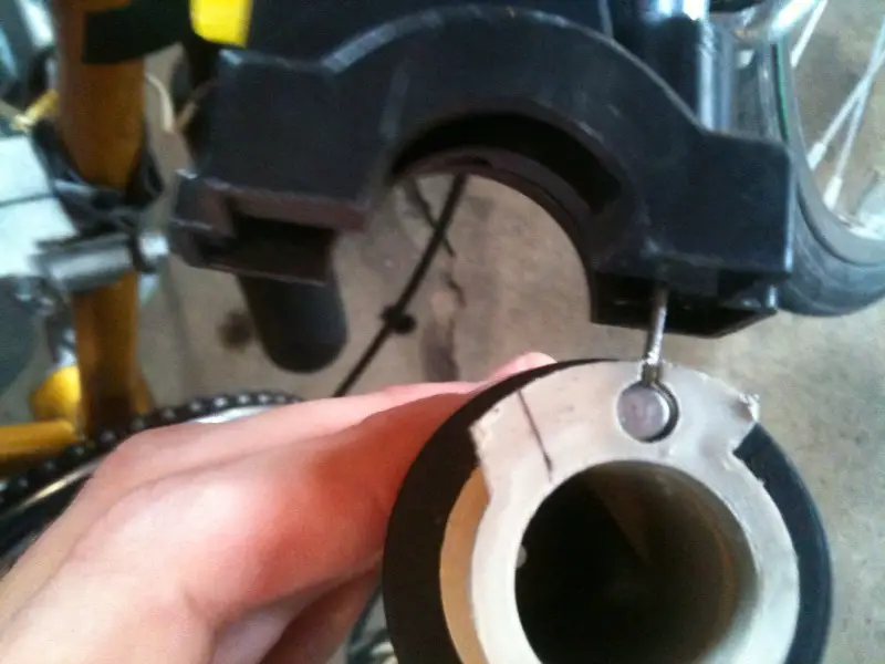

Alright sooo i got a new throttle and i put in on my bike and the throttle cable is too short i do have a aftermarket CNS carb and im not sure if it came with different throttle cable or if the stock one is just fine
they can be adjusted beyond what is available normally, but I'm failing to understand if it is inner or outer that is too short & if cable or throttle is new

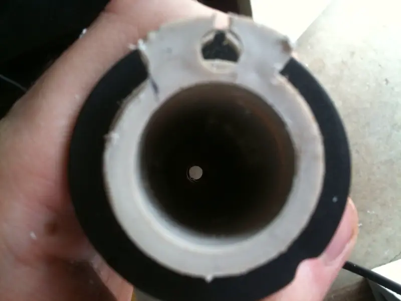

ah, it's the inner that's too short - open your throttle grip and CAREFULLY trim about 1/8in off both rails at the end of the nylon that forms the throttle stop

true that you can sometimes compress the spring more, but you still need enough cable to fully reach the bottom of the carb when you release the throttle - one should always hear a tiny click when throttle is released

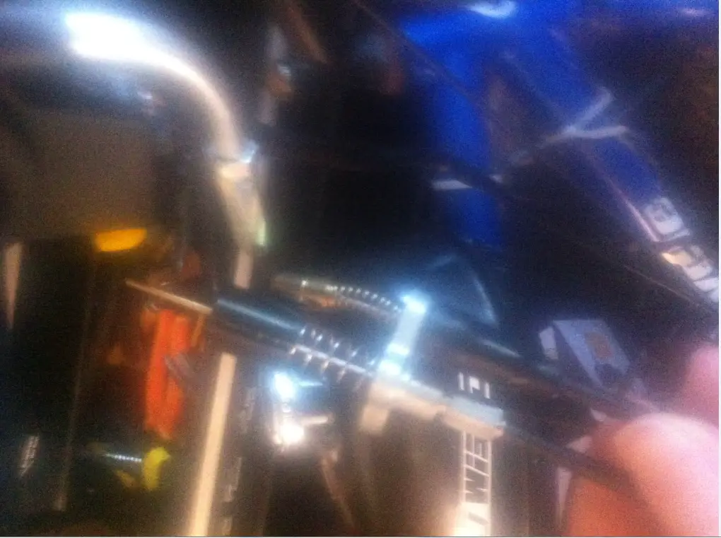

I chiseled the throttle thingy and then i took a picture, its still compressed to much I NEED CABLE!!!!!!!!!!!!!!!!!!!!!
