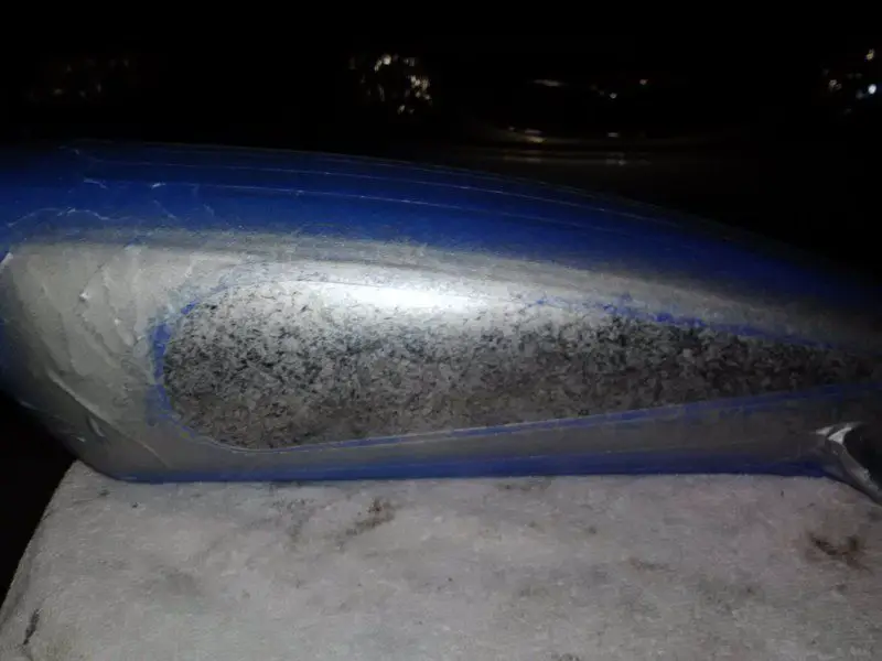

I sprayed them with silver & did a marbelizing technique to the silver.
here's how it looks with the silver after it's been marbelized. I know, it looks like a mess at this point but that's the whole idea.

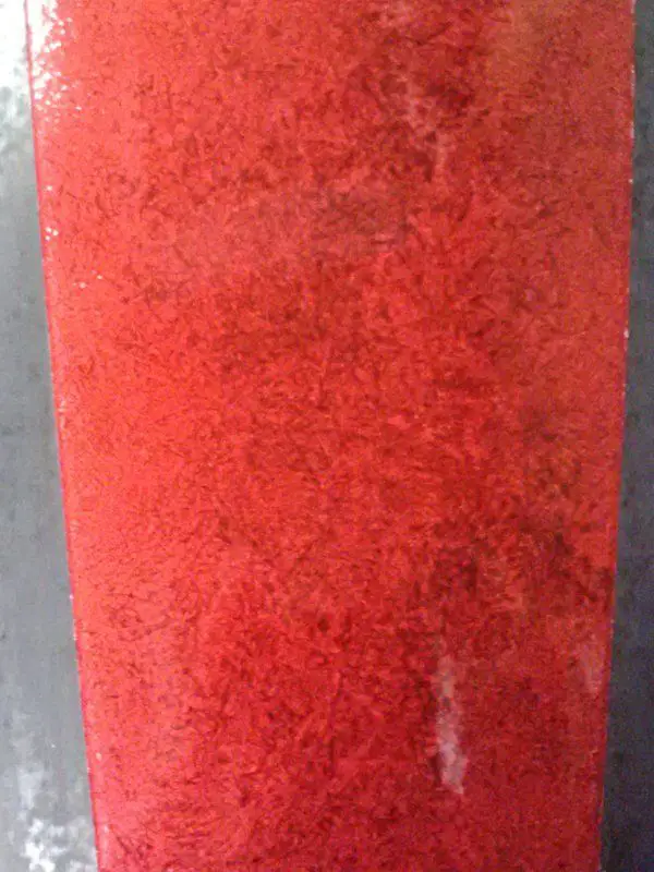

once the silver was fully dry, I sprayed candy apple red over the silver. the red is transparent and it needs a metallic base color (the silver) to make it shine.

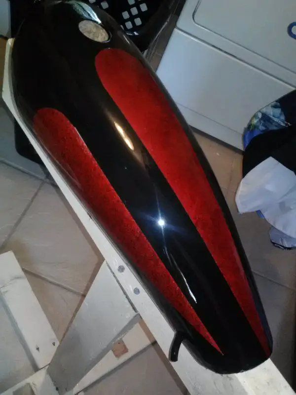

here's what it looked like after the red was sprayed on. (the black has been wet sanded in this picture.

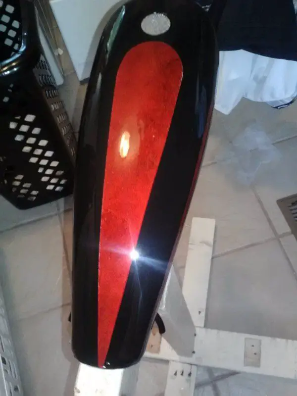

here it is after the first clear coat.

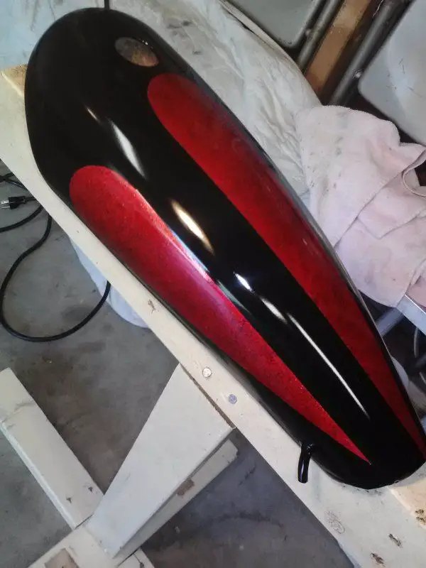

after the first coat of clear was dry, i laid on a heavier coat of clear and here's how it looks as of right now.
once this coat of clear is fully dry, i'll do 1-2 more heavy coats of clear, and then i'll outline the red with ivory pinstriping.
The more i look at it, the more it reminds me of a black widow spider. Maybe i should have done hour glass shapes rather than tear drops?
