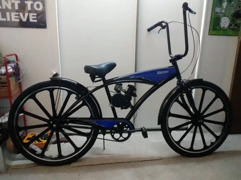

What's up crew, been a while since I been on here. I started a build in my bedroom as the cold set in, just something to mess around with. I don't currently have a garage. So had to keep the customization to a min. It's a Schwinn Kokomo. Picked it up from Walmart for like $150 . The motor is from eBay, it's the style with the head molded to the cylinder.

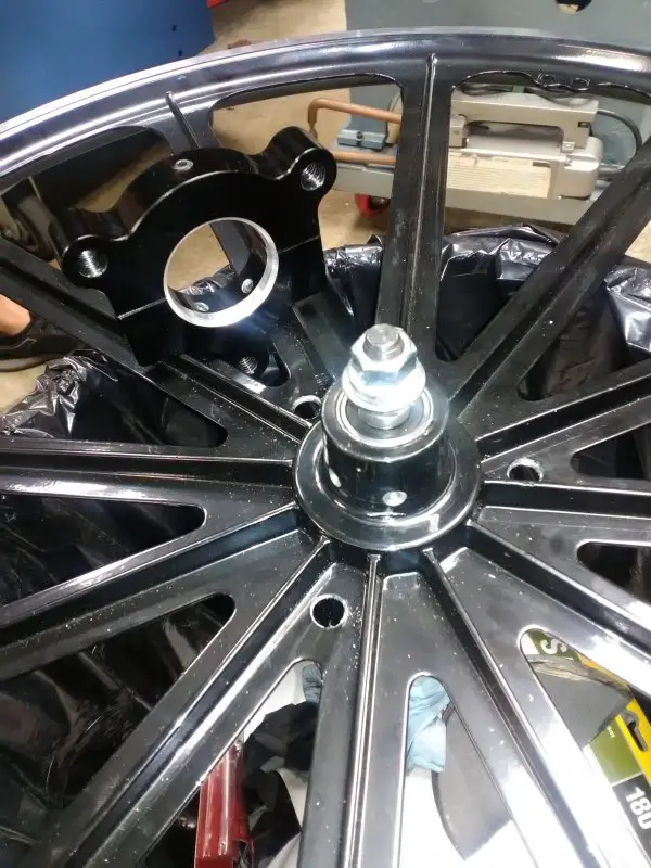

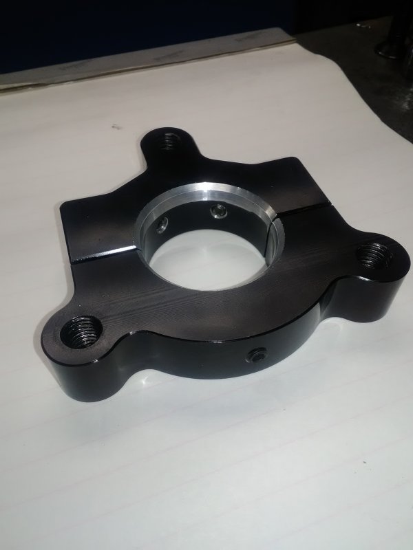

The hub on the wheel wasn't flush, it was tapered, which caused mounting issues with the adapter. I had it lathed, and set screws put in. Put shims on backside and drilled holes in wheel also for extra lock to the wheel. Turned out great

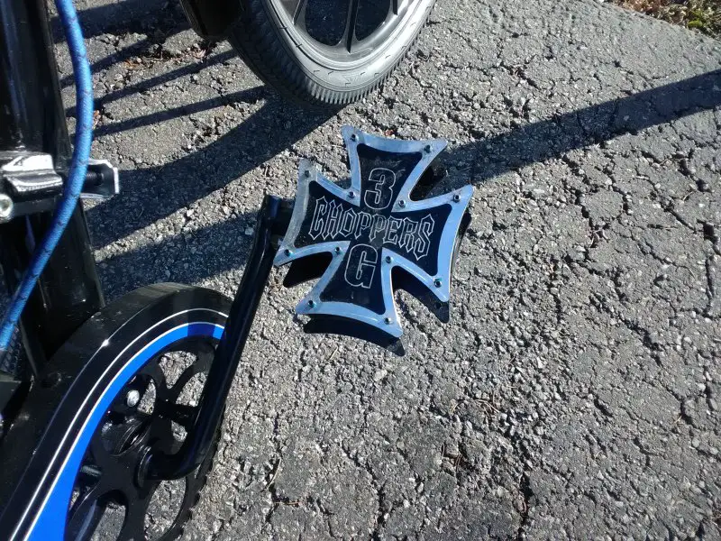

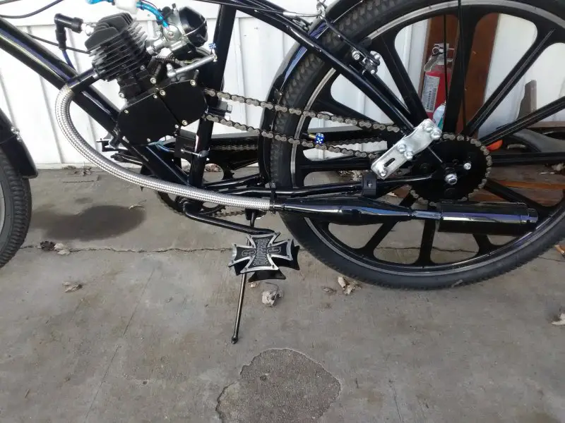

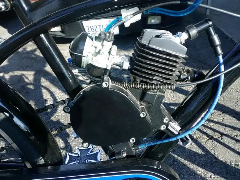

eBay exhaust worked perfect without modifications. Pedals from 3g bikes

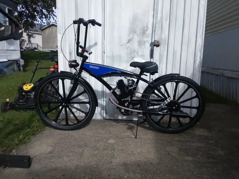

Dellorto carb, but I think it will run better with stock carb and small opening to stock filter
