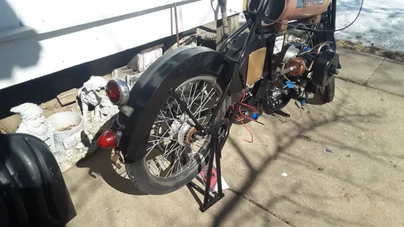

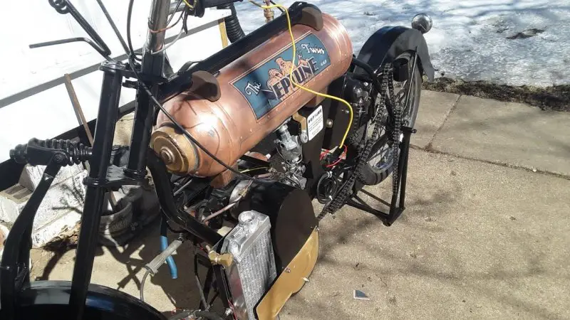

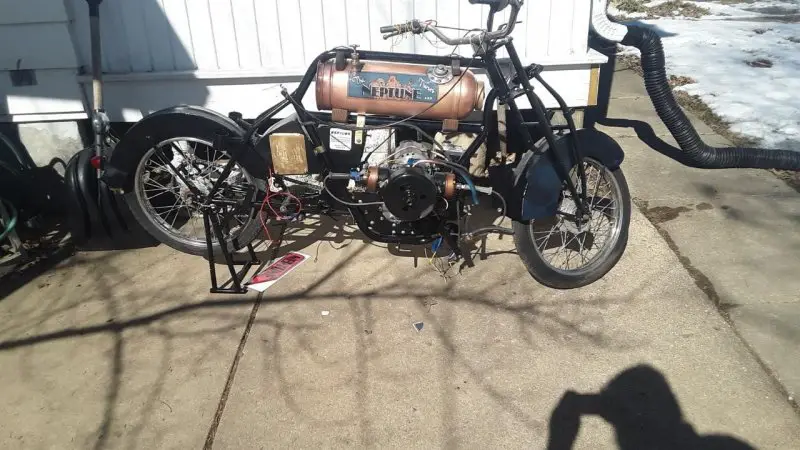

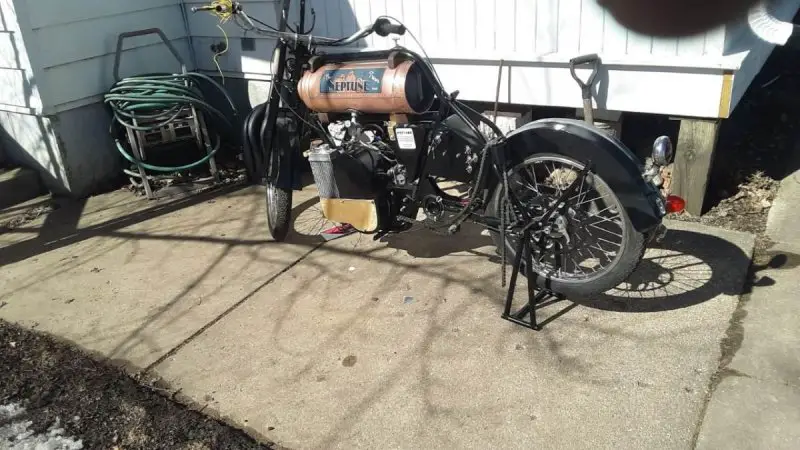

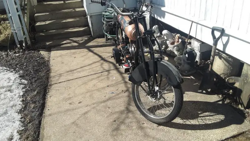

Hi all , Boo here . Making nice progress on final assembly of the 1922 Neptune , this has been a build a piece at a time from junk , then hang it on kinda project . I tore it all down , sanded & painted all the parts at an early elementary school talent level ....... then with tin work hanging by wire from the garage door tracks drying & dripping paint I found the old peanut butter jars with thousands of bolts , nuts & little brackets needed to put it back together. In a few ( very few ) cases I even figured out the proper order to re assemble it & avoided the dreaded put on take off repeat 'till you figure out where & how it goes . Hope to have it finished up this week , waiting on a friend that is making me a Brooks style seat cover.

Not solved , but not necessarily a problem ? me thinking is : motor is designed to suck up river water at 90 deg maximum , use it once & spit it out & only at whatever pressure it takes to shove the water back into the river . I am going to keep returning this water to the engine at what appears to be 150 deg in idle testing & at 12 lb pressure or whatever the rad cap is rated for . Dunno if the clearances in the motor are going to agree with the higher temps or if the head gaskets are going to handle the pressure on the coolant side of things ? Someone mentioned restricting the coolant flow to make it spend more time in the rad in front of the fan , but I am running 1/4 in lines so it is pretty restricted as is . I am adding an old small brass fire extinguisher made into another fluid reservoir that holds maybe a qt & a half, doubling current capacity. Will know better when my 300 lb being attempts the first uphill ride ? Good thing its got pedals ! Will update as I work my way thru it . Found an interesting story on line about a guy in the 60s or 70s that ran a 4 cyl german outboard on a cafe style bike & ruled the world in his class for several years , so it can be done !
