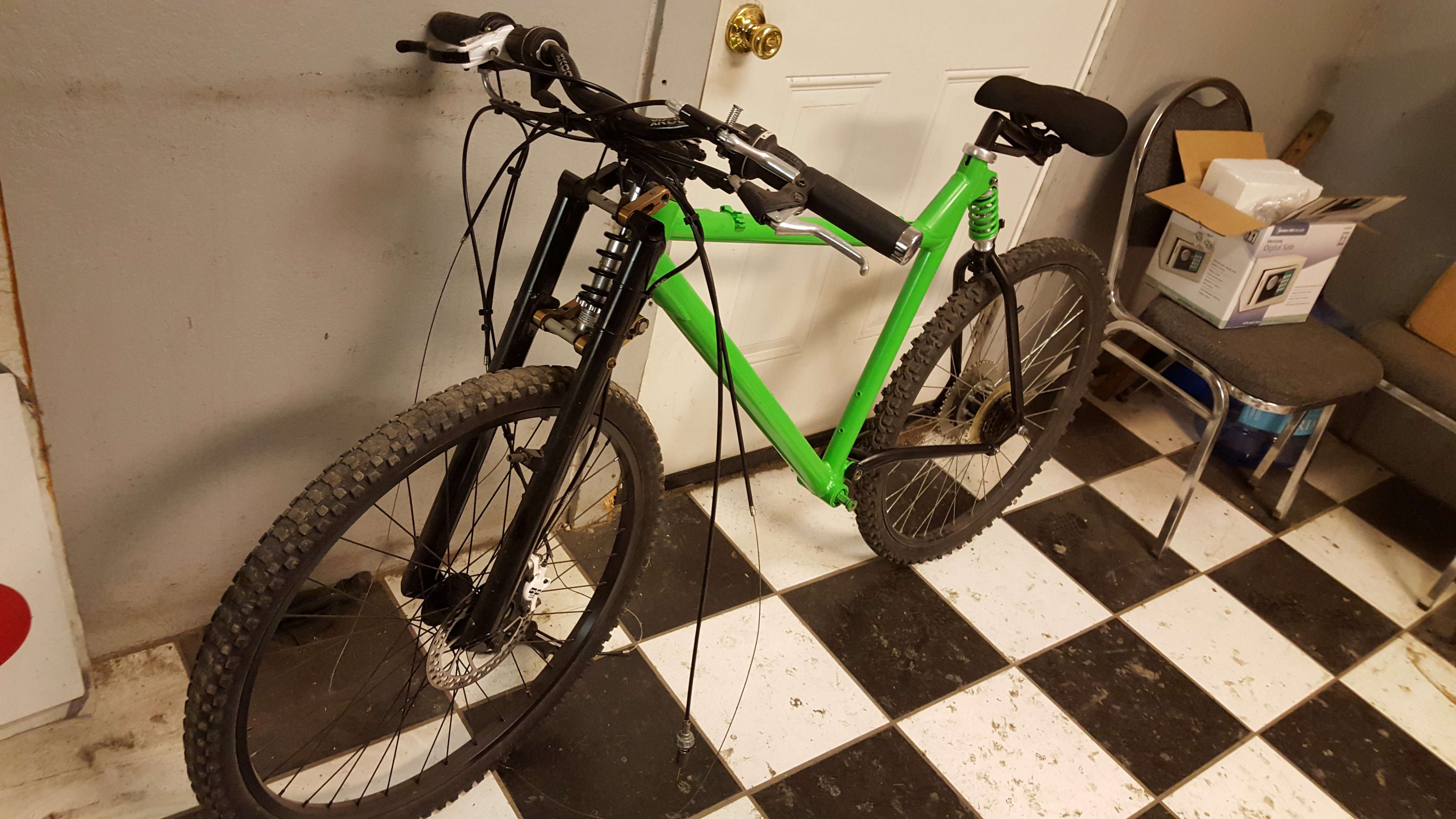

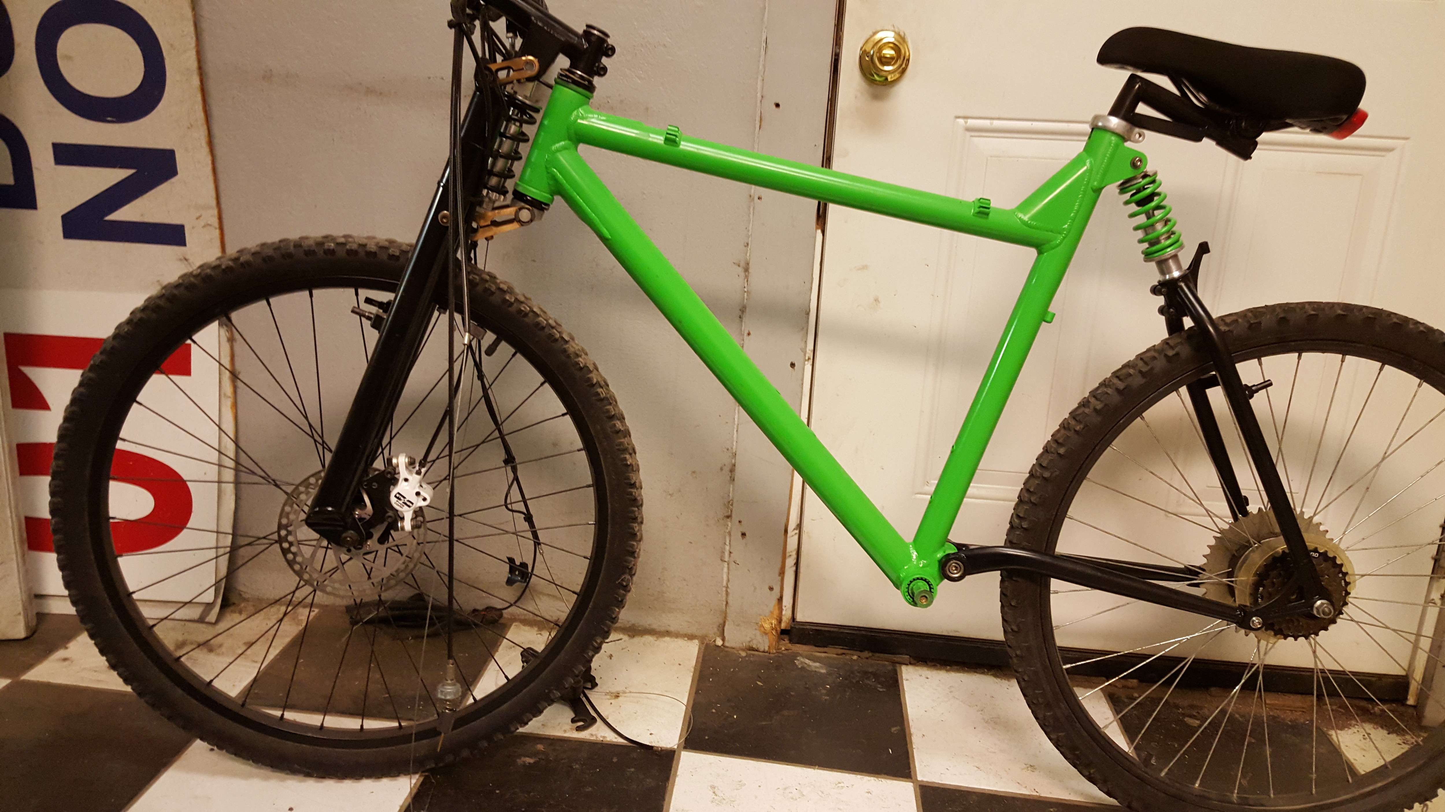

If you want an excellent fork that handles great at any speed and has a flare of uniqueness to it, the Noleen cross link or Vector front ends deliver... I got one and it did great at 45mph... like good enough to feel perfectly safe taking hands off the bars at speed. The girder design allows it to keep the same rake and trail regardless of how far the spring is compressed which means it will handle great no mattress what you throw it's way. Oh yeah... it looks cool too.... these came on a lot of the old proflex bikes and they quit making these in the early 90's but you can still find them on ebay from time to time and they range in price from just over $100 to well past $500 depending on condition and options as the basic unit uses aluminum forks and a polymer spring and the top of the line unit uses carbon fiber fork tube and an electronic "smart shock".
Mine is a modified Vector where I took out the polymer and replaced it with a modified go kart shock and a custom spring for these front ends. The fork setup costed me about $120 then I took it apart, painted it black, replaced the bushings that needed replaced, modified a go kart shock to fit it and installed the spring upgrade spring they make for these. Total cost after being modified, rebuilt, and reworked was just over $200. Also these don't come with disc brake brackets but they're easy to modify using a steel or billet bracket.
Here it is on my new frame... if I ever get enough time to put my old engine in it...
