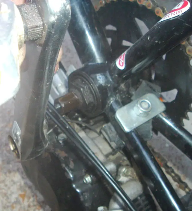

I really need to find some way to extent the crankshaft out so it won't hang-up in the engine.
The big challenge is creating an extender from the crank to the pedal. The temptation is to just replace the really nice GT/Dyno crankset with a less substantial one. But I really like the beefy GT/Dyno set-up.
