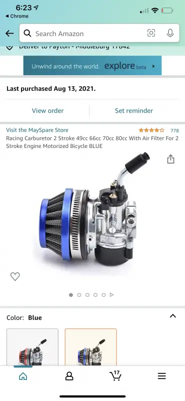

Sorry i havent replied in awhile i havent been checking this but this is my carb
I would like to see your perfomance carb, if it's the same as mine, needs to be leaned right out. I'm at 2200ft elevation, I think. And the .65 still too rich, got another pack of jets coming maybe Oct., I still got my stock carb on and works good., for the slack, pull the cable screw out of your stock carb, sits right in the end, I may have cut mine to fit.. oh ya the fuel filters that come with leak, go to your local parts dept get a nice smaller hi flow, I think they look better, but I dont like piss yellow paper filter. Best luck
Ok i might just have to get a stock carb again ‍♂️
