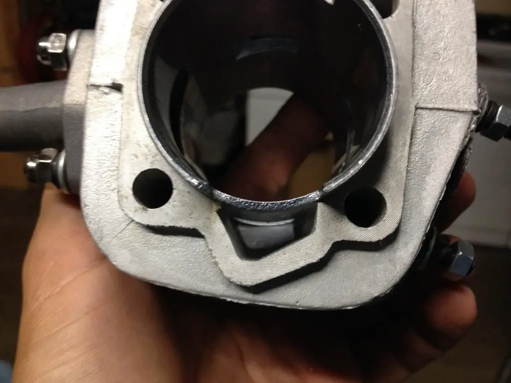

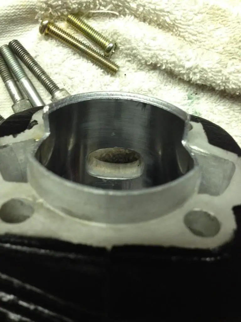

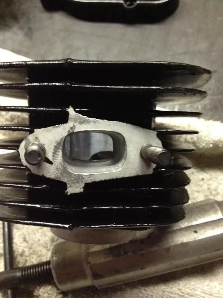

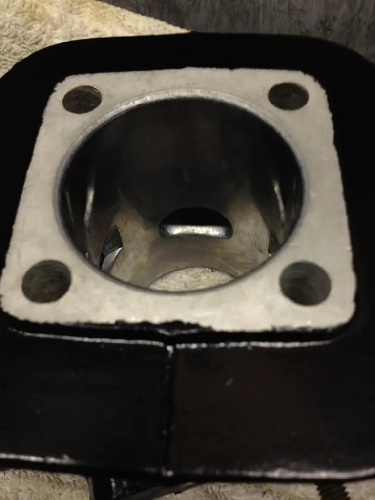

port cleanup looks good, where you hit the wall near the transfer will be ok as long as it's not a deep gouge that runs the same direction as the rings (horizontally), but even then it would just need a little polishing and would most likely end up a non issue. the important stuff is to clean up the extra plating flash that ends up in the ports because it can start flaking off from those areas but once cleaned up and chamfered it completely prevents that potential problem.

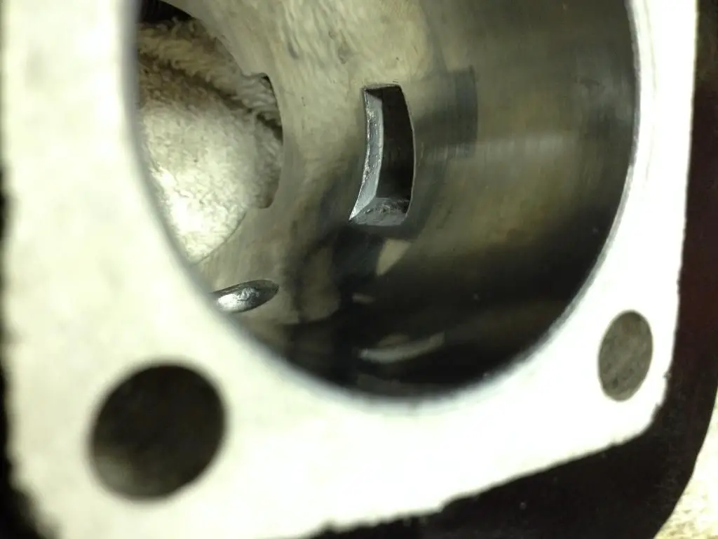

There is a casting seam inside the transfer ports at the roofs that should be cleaned up if you can get in there with a dremel, pencil grinder, or even jeweler's files, it is worthwhile to clean that area and the engine will perform slightly better.
