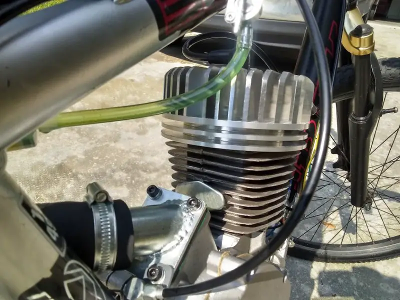

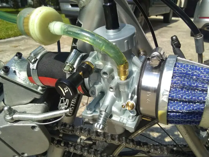

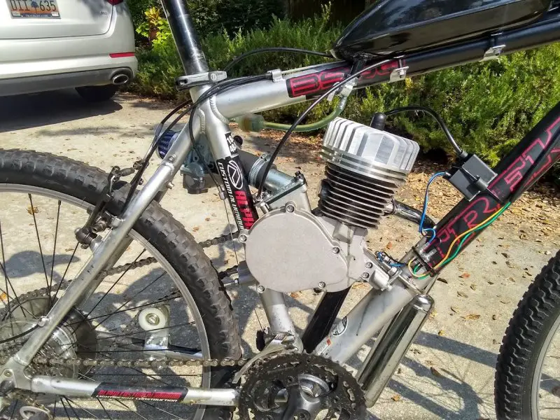

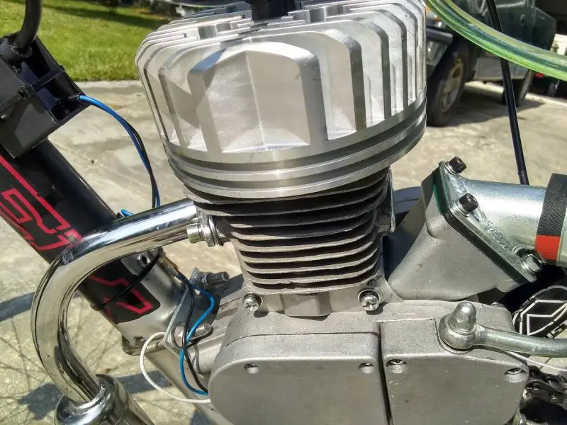

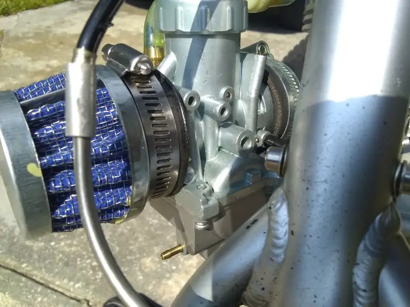

Here are some pics of the build.
bairdco, you happen to know where I could find an idle jet kit for a GT90 kit? The GT80 jet kit has main jets that are compatible with the GT90 but a reviewer said only the jet kits’ main jets are compatible with the Keihin clone carb that comes with the GT90.
We’ve already tried adjusting the float level and like you said, it didn’t change much

Ryan you have the engine I referred to: it's a case inducted reed valve engine and if it came from Gas Bikes it has a third port machined into the jug and a window piston...Kehin carb....so what I suggested is quite applicable although the idle circuit could be way off as well. Reed engines are night and day different than piston port timed motors; like come with the stock China girl kits.
Stiff reeds when new block almost all air/fuel flow coming into the motor at low rpm, the engine has to work hard to get started but then when rpms build up the motor acts like an air compressor and causes the reeds to open really open up and the engine then has ample air and fuel to run properly at speed once the reeds start to flex the motor should start and pull at low speed, though idle circuit may need adjustment it's true. Good news is the reeds typically don't take nearly as long to break in as the engine does.
Good luck it's a nice looking motor!
