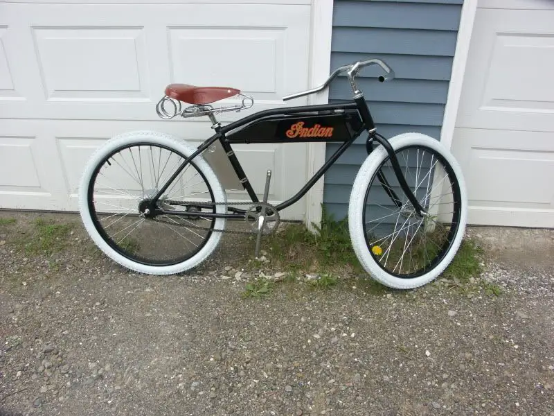

Where im at now. Ill have to grind down the butten head screws or chamfer the sprocket. They hit the coaster brake. So thath about all i can do for now. Oh yeah ill drop the bars back down when im done they hit the tank!

The chain alignment is always one of the biggest hassles, to do it right takes time, but there is no alternative to doing it right. As a guy who has white walls I'll give you a little tip that might help keep those pretty white tires clean:
Snip off all the little whiskers left on the tires from the molding process. If not, each time they go by the chain they grab a little oil and you'll have evenly spaced greasy spots on your tires.
Overall, the build is looking pretty good..
you know, they sell a bent arm coaster lever @pirate that should solve this problem for you, and give you quite a bit more room to laterally adjust the manic adapter! did mine myself, before I saw the one @ pirate, was a pain in the arse!
